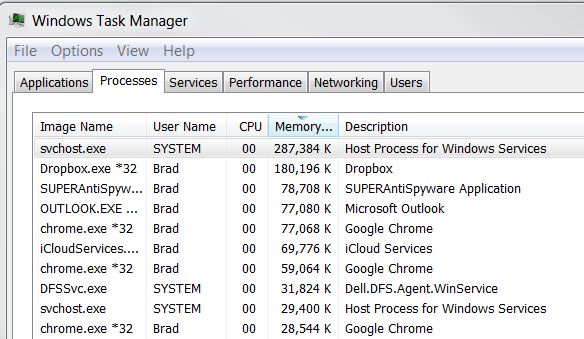

Well... it is Wednesday. Started in earnest really yesterday. I am not sure if it is due to the buggy icad software program OR the fact that my dropbox is syncing non-stop (I will try to remember to pause the DB sync while I need to crank out these dwg deadlines this week) OR a little of both, but icad has been hanging up with the most simple commands today. I bought the bestest and baaddest Dell Precision ($4k) laptop, so I would hope that the computer is not the trouble, but maybe the first week with a new computer settings, etc...
Oh yeah, by the way does anybody have a romant.shx file they would please share with me?
Thanks for listening.
Also, what is a Host Process for Windows Services?
Posted : March 16, 2016 7:53 am

Pausing dropbox, easier said than done. But damn, with 32GB RAM, this should not be the issue, right?
Posted : March 16, 2016 8:21 am

Your dropbox is taking alot of memory. Sometimes it could not be the RAM issue but the processor if the programme is not optimized to use multi core processors. Can disable it to run on start up and later sync when you need it.
Posted : March 16, 2016 6:41 pm
sireath, post: 362711, member: 9370 wrote: Your dropbox is taking alot of memory. Sometimes it could not be the RAM issue but the processor if the programme is not optimized to use multi core processors. Can disable it to run on start up and later sync when you need it.
Yes, I agree. A friend of mine told me to just let drop box do its initial syncing (even if it takes a few days). It started syncing 248,000 files, now it is down to 168,000. So I have been barely keeping up with deadlines using my old laptop in the meantime, while my new laptop is syncing smoothly now, so far so good.
I am still looking forward to a successful run with Carlson 2016 Intellicad 8.1 once my new laptop has all of its Windows Updates and Drop Box is synced, etc.
Thanks, sireath, for confirming what my friend told me, that is very helpful.
