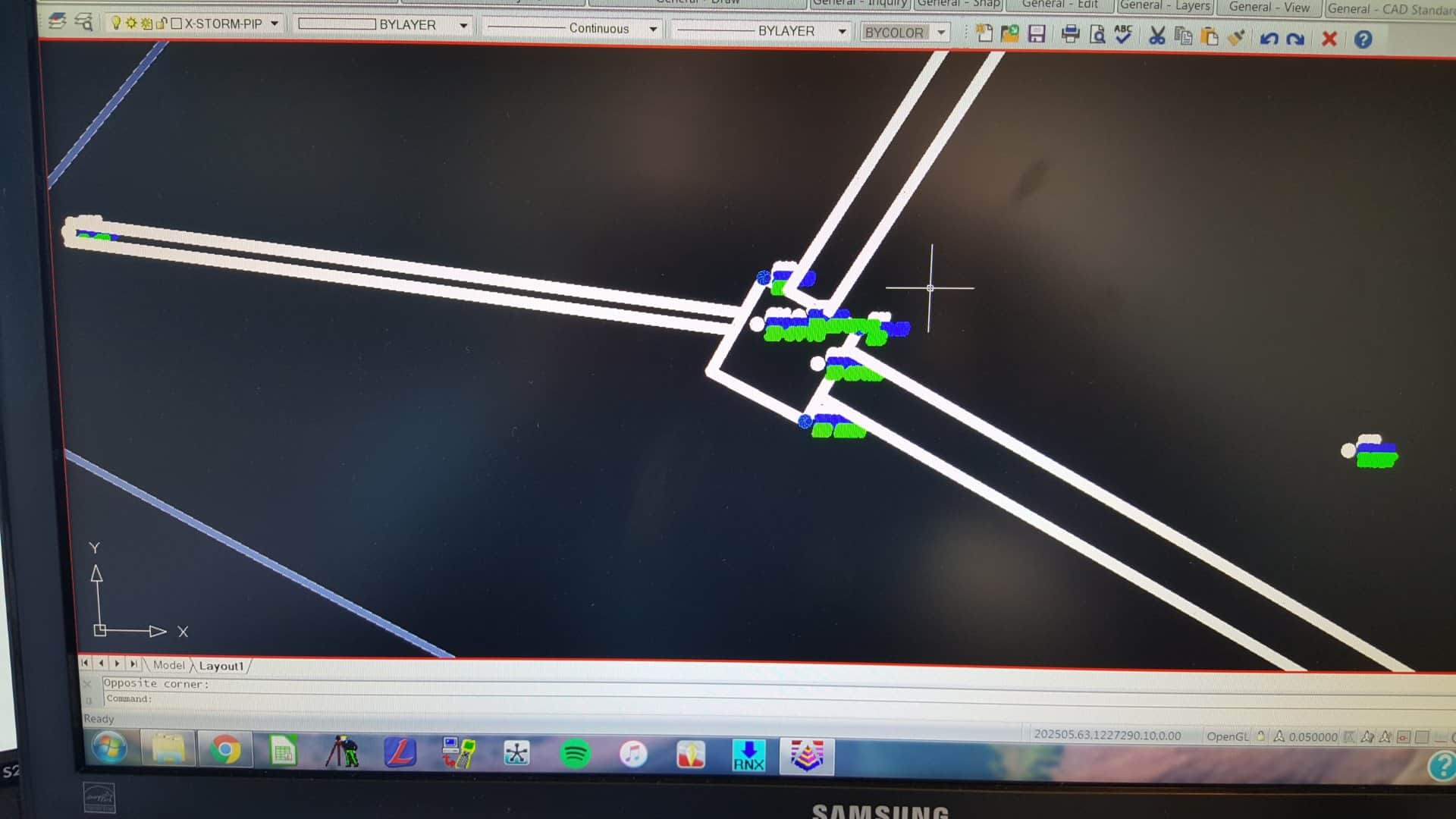

I am not an expert on PS/MS, but here's one that's driving me nuts.
Below shows a Paper Space view of a section of a job I am working on. Does anyone know why my points are fuzzy and not readable? This only happens in Paper Space (Model Space, they show up great).

Looks like you are set to display lineweights. Try turning it off.

Line weight is being displayed when you are in paper space. If you're using layer dependent line weights, just change the line weight for the point layers to a thinner setting.
Everyone uses the tools differently, but for me this never causes a problem. I draft in model space, print any worksheets displaying point data from model space, etc. Paper space for me is all about legends, notes, borders, and viewports to properly plot my handiwork from model space.

Paul D, post: 375800, member: 323 wrote: Looks like you are set to display lineweights. Try turning it off.
Bingo!
Thanks!
