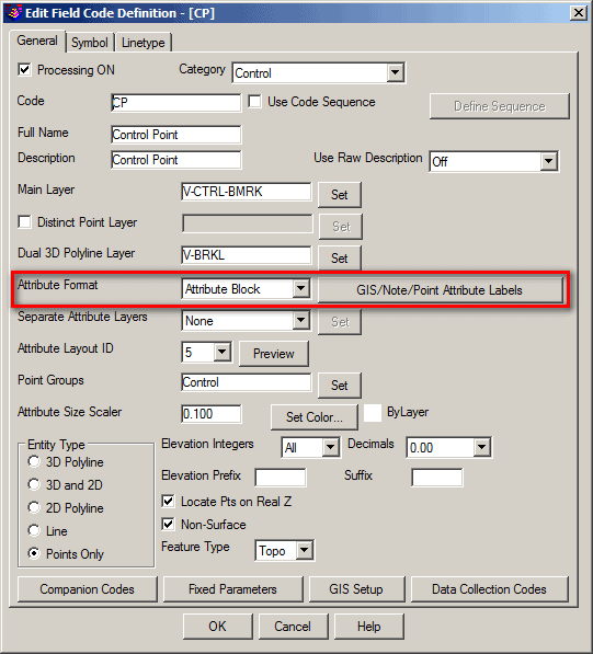

How do I have the software automatically use romans.shx font rather than having to set it that way every time I open a drawing for the PTXT style?
Ladd offered these suggestions, the first I tried, but for some reason is not working, the second scares me:

hlbennettpls, post: 367020, member: 10049 wrote: When I got to update my *.dwt, I don't even have the PTXT style listed! They could really do a better job w/this stuff...
The PTXT (Point Text) style is/are defined in the ten different point attribute layout ID blocks (srvpnoX.dwg, where X = a number between 0 and 9... e.g. srvpno3.dwg or srvpno5.dwg, etc) and the https://knowledge.autodesk.com/support/autocad/learn-explore/caas/CloudHelp/cloudhelp/2016/ENU/AutoCAD-Core/files/GUID-BC0FD3C1-3BFC-4C5D-AB9A-BF480D5084BE-htm.html&apos ;">rules of block insertions govern. There is, however, one additional consideration:
Autodesk holds the copyright on the RomanS.shx font. Since the ITC cannot (and does not) redistribute this font, IntelliCAD performs a http://www.carlsonsw.com/support/knowledge-base/?action=display_topic&topic_id=602&apos ;">font substitution when it cannot find a font specified in a given text style. Based on this, I suspect one of three things might be happening:
  1. The RomanS font cannot be found within the Support File Search path of the CAD application (presumed to be IntelliCAD in this case), or,
  2. The PTXT text style in the aforementioned srvpnoX.dwg file(s) has/have not been updated to utilize the RomanS font, or,
  3. A PTXT text style has not been created or defined in either the template (*.DWT) drawing and/or active drawing in which a point is being inserted.
In all three cases, it will be up to the user to figure out which solution(s) they'll want to implement. I have, however, updated the http://www.carlsonsw.com/support/knowledge-base/?action=display_topic&topic_id=779&apos ;">Customized Carlson Point Attribute Layouts article to include a collection of https://update.carlsonsw.com/kbase_attach/779/SrvPNo-RomanS.zip&apos ;">attributes that call for the RomanS font.
I hope this information helps.
Posted : April 13, 2016 9:00 am

hlbennettpls, post: 367188, member: 10049 wrote: Created the style PTXT in my *.dwt file, and it completely ignored it and went back to standard txt font. Do I have to do that as well as update the text in the srvpnoX.dwg file?!
Creating a text style (e.g. PTXT) in a *.DWT file would make that style available in any new subsequent drawings created from the DWT file... it would not "ripple" into any existing drawings. In my case, I:
  1. Updated my DWT file to have the text style(s) (and desired font associated with each text style) and saved the DWT file. As an example, I used the Impact font for the PTXT style.
  2. Created a new DWG based on the modified DWT file.
  3. Inserted points into my DWG using the aforementioned https://update.carlsonsw.com/kbase_attach/779/SrvPNo-RomanS.zip&apos ;">attributes that call for the RomanS font.
Since I had explicitly defined my DWT (and subsequently new DWG files) with a PTXT style that calls for the Impact font, the points and their block attributes were placed (as expected) with the Impact font despite the fact that the underlying definitions were based on the RomanS font. This presumes, however, that a given field code has been structured to use the "Attribute Block" setting (this is the approach I commonly recommend):
If your system is configure for the "Text Attribute", you'll need to identify the text style(s) for each of the attributes for each of your field codes. I hope this information helps.
