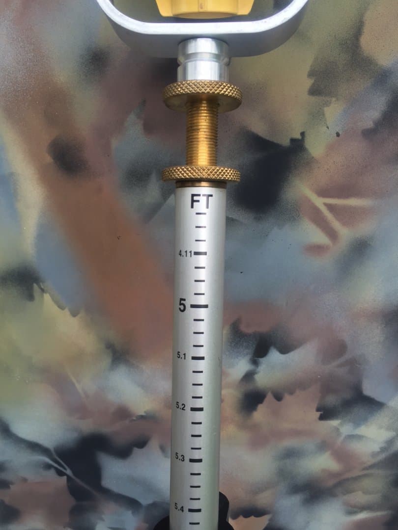

Since I've begun learning the art and craft of surveying, I've spend a great deal of time identifying the sources, and quantifying the magnitude of various errors that can creep into the process.
My recent obsession with elevation errors, which led to a "simple" triangular traverse, resulted in a renewed interest in paying attention to "measure ups", using great care in measuring HI's and HR's.
Quite by accident, I was going over my tribrachs, prism poles, etc., and I noticed this:
See the "4.11"? Never noticed it before. Guess what? The pole is not read in feet and tenths, as I have been doing since I bought it! Who'd guess that 5.4 meant 5'-4"? Not this Grasshopper, apparently. I've calculated that, depending on the distribution of the setup heights, generally between 5.0' and 6.0', that I've been introducing an error averaging .092' into my traverses, reading and recording tenths rather than inches!
I often use the prism pole and tripod for initial back sights (working solo), so that I can free my tripods/tribrachs for traverse points, so it means that if off by .093' on the initial back sight, this will propagate throughout the traverse! Almost a TENTH!
Argh!:-$:-$:-$:-$

Well!!! I don't know if I would have noticed that myself! Can't recall ever seeing a prism pole in inches before. 1/4 inch graduations at that. You traverses will never be the same. 😀

I think it's because I bought it from a concrete contractor. Do construction folks use feet and inches as a general rule? I'm thinking of scribing or etching it in tenths. I don't need another "conversion" task to be thinking about.

I suggest you check the height of the rod, prior to beginning your field work for the day. Hook an engineer's hand tape on on the rod tip and measure up. You will be measuring the hypotenuse and if you have a 0.3' offset to the center of the mirror, you would subtract 0.01 at 5 foot height. The rod height is adjustable for different mirrors and will adjust during the course of a survey if you are not careful or something else can go wrong.
The conversion is easy and you should be able to do it in your head once you realize the .25' = 3" and you have to go to the nearest 3" increment to subtract or add since 0.125' = inch and a half. With that in mind, 1/8" is equal to 0.01' until you get an inch and a half or in other words 1 3/8" or 11 - 1/8" increments =0.11'.

I never use the numbers on the rod. We always measure.

I've never even thought of doing it, numbers on the rod are just approximations as far as I'm concerned. Occasionally I will use them to measure something when I didn't have a tape with me for some reason.:-S
You do get used to each rod, they are all so different, the one I use most is 0.12' low for my GPS measure, different for a total station prism, and different for all the robot glass.

I wonder whether that threaded portion is always screwed in the same amount - another small variable.
Posted : September 21, 2015 7:27 am
Bill93, post: 337266, member: 87 wrote: I wonder whether that threaded portion is always screwed in the same amount - another small variable.
No. I've adjusted that very carefully, lol. I set the pole at "5", and measured up to the centerline of the prism target. At 5'-0" (5.0'), it's dead on!:-D

get rid of the rod, It will haunt you some day and you will lose more time and money then the cost of an new rod. also always measure your rod height don't rely on the marks on the rod. I always liked to use the peanut prism the height never matches the pole.

It's not difficult to make a spacer that is mounted to the base of the peanut prism that boots the prism to the correct height so that you can have more hours in the day to do better things than measuring your rod height with a pocket tape every time you need to raise/lower it.
Somebody with a lathe could easily make the correct part.

Or you can set it to an even foot and note the height on the rod
