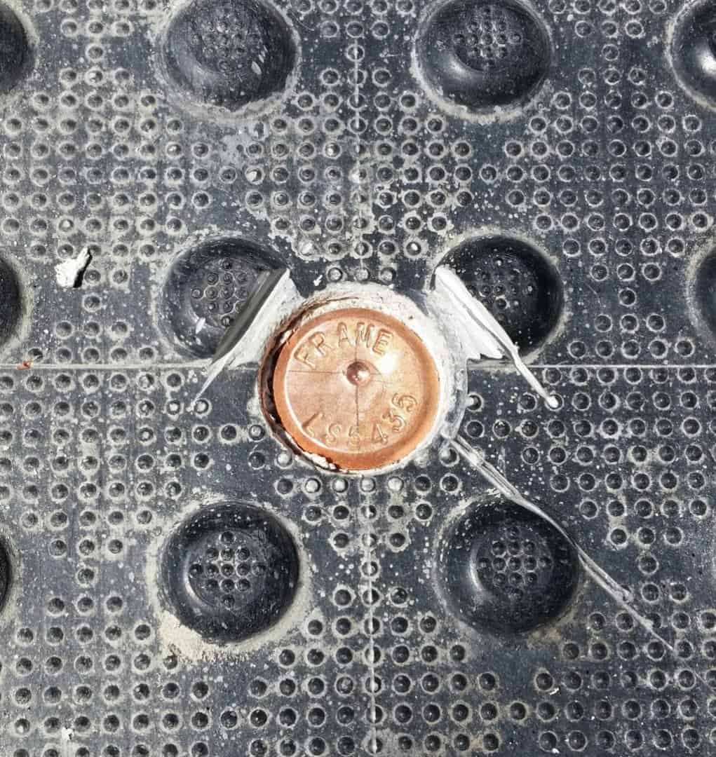

One of the monuments I needed to set this morning landed in the plastic insert of a handicap ramp. I've seen these things a bazillion times, and even casually seen them being installed, but I've never actually had to set a mark in one.
Everything went normally until the face of the Berntsen bit hit the tops of the plastic bumps. At first I thought I could just melt my way through them, but that didn't work. It wasn't until I had cut through them with a diamond saw that I realized that the bumps are filled with whatever binds the plastic to the concrete, apparently some kind of mortar. One I cut those pieces off, the bit was able to penetrate the plastic below. The countersinking tips just barely got through it, though, and I had to use a few taps of a chisel to get the last piece of the plastic donut out of the hole.
In the end it turned out okay:

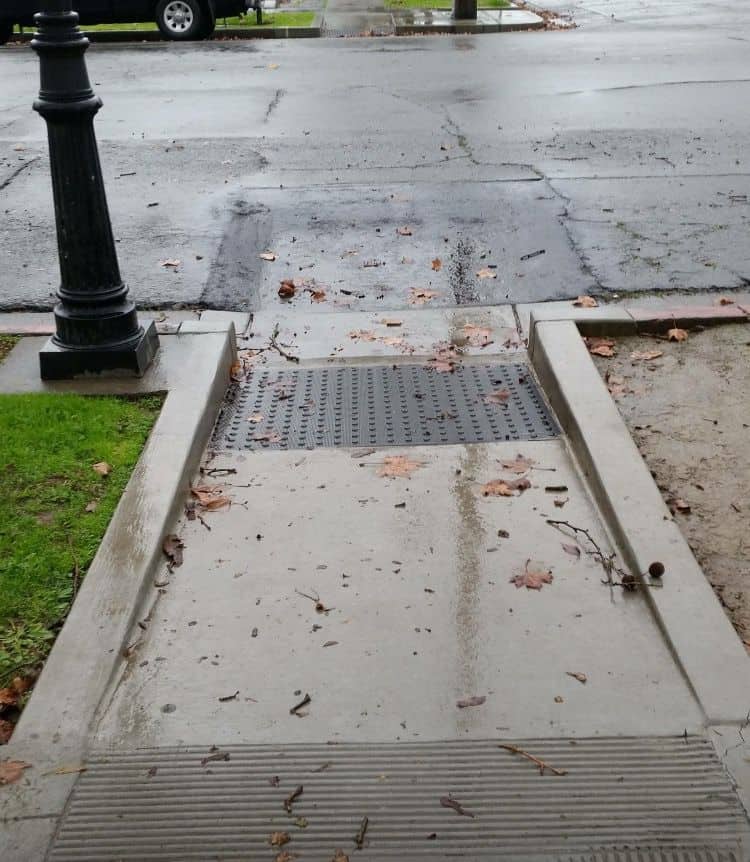

The thought did occur to me that I might be wandering into delicate territory, but on the other hand this is in a city that thought the following was a good way to retrofit handicap ramps into streets with too much slope adjacent to the gutter:
This is just one example of several around town. Anyone is an underpowered wheelchair who descends the ramp isn't going to get out of that hole except by backtracking.

It's a Berntsen 1" copper disk with stem, installed with a plastic insert. No snow around here, so I don't use the magnets.

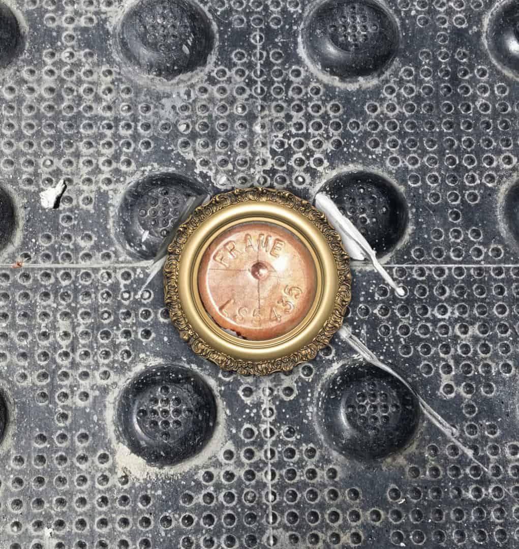

Posted : July 13, 2017 9:26 pm
The client didn't want to pay for the deluxe version, so I installed the base model.
Posted : July 13, 2017 9:33 pm
Fancy...;)

I never thought I would see the day when drainage was less important than the percent of slope as read on a smart level. Literally changing the gutter pans on existing curbs forcing water to hold upstream in my local town. Need a outbreak of some mosquito borne disease caused by birdbaths in ADA retrofits to bring some common sense back. Jp
