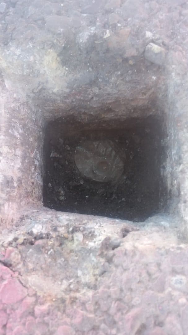

So back to work after a few days away and my bloodhound came in while I was gone. Starting off with I am very impressed. It is very light and has a bag to carry:D:D:D. The fence detection is awesome. A little time in the field picking up a few different things learning some tones and you'll know when you have a mag, rebar, or 60d. A clear difference between trash and a survey type marker. Right out of the bag I was searching for rebars along a chain link fence. All very close where my 52 wouldn't have shown a difference. Same day and I mean pin pointed a cap buried under the asphalt. I kind of drove my prick into the cap lol. I have a pic see if I can get it uploaded. Few days later doing some searches on a plat from the 50's found lots of things confident I would've never found before. The best was the 1/2" rebar about 1.5 feet down. It sat next to a large chunk of metal 2 tenths away and about a tenth below the top. Clear tone between the two objects. I'm not one to give up that easy and curious to see what this detector was picking up on. I think most would've walked away seeing the garbage metal.

Ok let's try this photo thing here this time and not some random pm message lol
