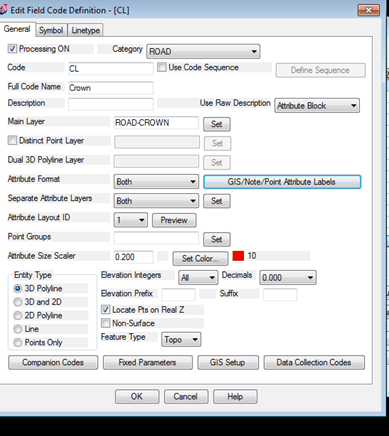

You can easily contour in Carlson without having points on Real Z.
In my opinion, there's no value in having points on elevation, but the draw-backs are numerous.

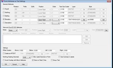

Try setting up F2F and select GIS Note/Point Atribute Labels, you can end up with Carlson Points and Text on different layers
