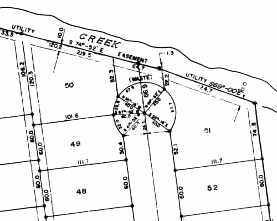

Found this designation on a subdivision plat from 1969. There are no notes on the plat which define what a "waste" parcel is. Has anyone out there in survey land ever seen this type of designation on a plat? If so, what does it represent?
The Owner's Dedication reads:
[INDENT][INDENT]‰ÛÏI have caused said tract to be subdivided into lots to be known as the __________ Subdivision, and that I hereby dedicate and relinquish to the public for public use all streets or roads shown thereon.‰Û
[/INDENT][/INDENT]
The acceptance reads:
[INDENT][INDENT]‰ÛÏThe County of _________ Approves this subdivision and hereby accepts the dedication of all streets, easements, and other parcels of land intended for public purposes for the perpetual use of the public.‰Û
[/INDENT][/INDENT]

I have not seen one described that way. I have seen parcels described as uneconomic remnant meaning that they are not suitable for development, in other words wasted.

If I were doing that sub and knew that parcel wasn't buildable, I would have included it with lot 50 and 51. I guess the question is, who owns it, the public or the developer? The way the pins are set puts even more doubt in my mind.

As for the waste area, my guess is it is part of the ROW that was not planned to be constructed. One of the reasons I suspect that is the extension of the centerline. Pre 1980's plats are full of this kind of lazy platting. I guess the thinking was that no one would care, or that everyone would think exactly like the platting surveyor or be able to read the minds of the deceased.

Even though it doesn't seem likely because of the creek that is shown, it is possible that it provides the possibility of the street continuing?

Looks to me like something purposely not conveyed, or maybe included in dedication deed, for the future to potentially continue the road

It is clear that the developer does not want to retain it, but the County probably does not want to accept it. If the County accepts it they may be required to extend the road at public expense at some future date.
The owners of lots 50 & 51 will probably cut the grass, but why pay taxes on it? It is essentially a designation of right of way for future use.

Bizarre. Such a plat should never be accepted. I've seen some stupid things in my day but this is a doozy of a stupid thing. It needs to either go with one lot or the other or be split between them in some convenient location.

I own lot 48 and know that area was for fishing access for lots without creek frontage. Been fishing there for years, try and stop me.
