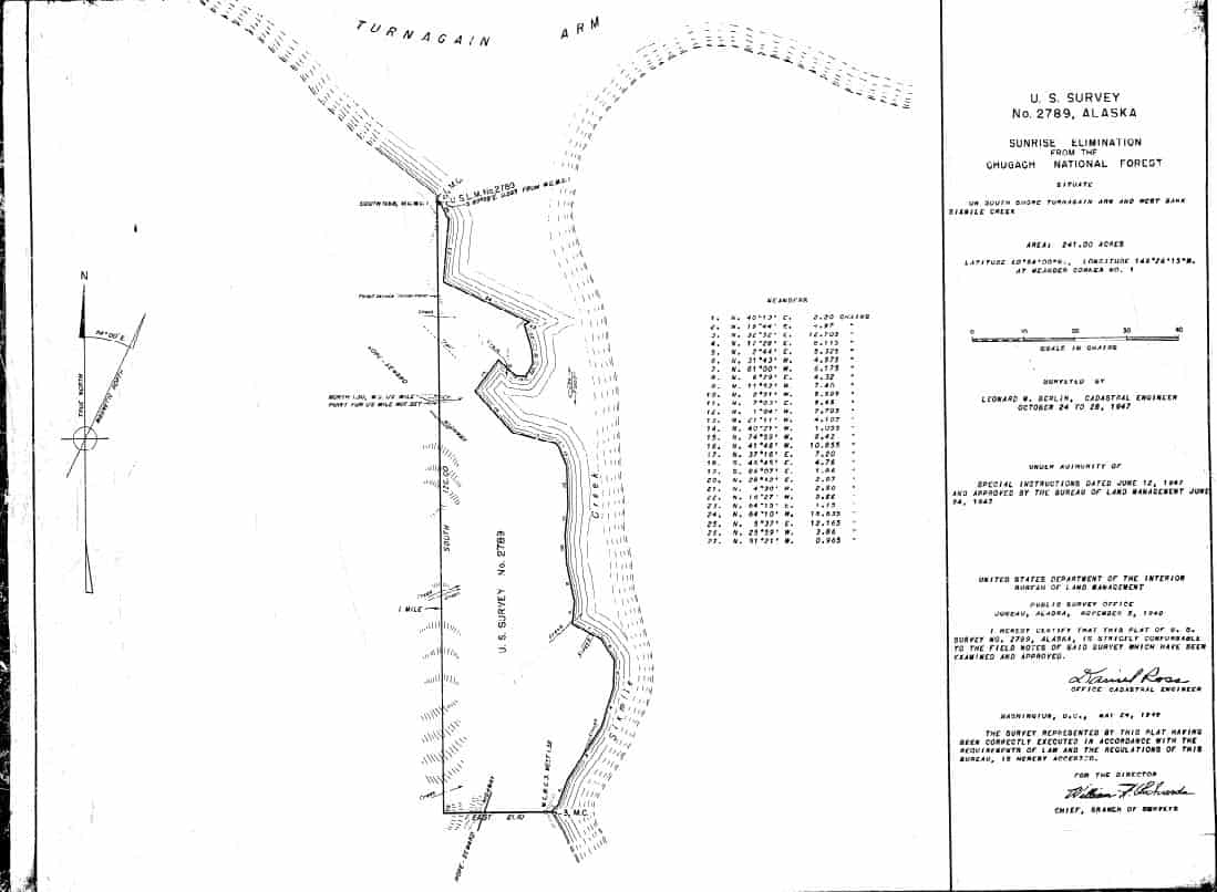

Loyal, post: 453495, member: 228 wrote: How about this one?
I've had to deal with quite a number of these over the years. Typically done before the rectangular surveys and are excluded. What mostly drove my work with these was the fact that the patentee often acquired mineral rights prior to statehood. Don't think I've ever had one close perfectly.
Seems like I read some years ago that you will not get a perfect closure on a GLO/BLM section due to the curvature of the East-West lines using the bearings and distances shown on the plat or in the notes.

Charles L. Dowdell, post: 453525, member: 82 wrote: Seems like I read some years ago that you will not get a perfect closure on a GLO/BLM section due to the curvature of the East-West lines using the bearings and distances shown on the plat or in the notes.
You will not get perfect closure if you check the closure on a plane. The bearings are geodetic.
I ran this one out and for a BLM survey it has a good closure, 1:19717, S 88?ø51'31"E-0.016 links closing to to starting point (SW Corner)
Posted : November 1, 2017 9:28 pm
Charles L. Dowdell, post: 453548, member: 82 wrote: I ran this one out and for a BLM survey it has a good closure, 1:19717, S 88?ø51'31"E-0.016 links closing to to starting point (SW Corner)
Right on Mr. Dowdell!
It "closes" nearly perfectly (if you know what you are doing).
Posted : November 1, 2017 9:52 pm
MightyMoe, post: 453496, member: 700 wrote: What is the date on it?
Field work 2009-2010, approved in 2012
decimal minutes???
Posted : November 2, 2017 8:27 am
Dan Patterson, post: 453596, member: 1179 wrote: decimal minutes???
Yup!
Posted : November 2, 2017 8:51 am
