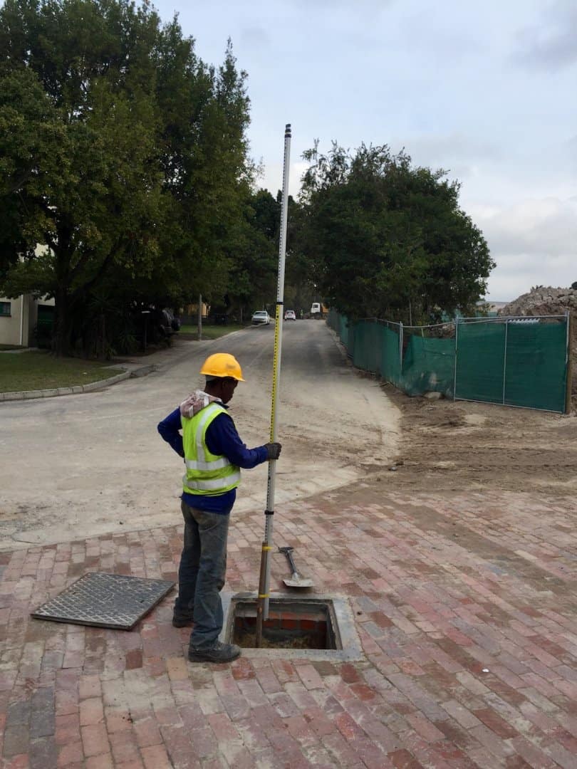

Over the years and on this forum there have been many variations on how to measure sewer drain inverts and not get the rod full of Sh!t.
I have been a wrap it it plastic bags or cling wrap man for many years, but getting them off after the job has always been a pain.
Came across this guy straight out of college, stuck the rod on a 0.5m offset on a lathe and happily measuring sewer inverts. Rod stays dry, and easy to remove it at the end.
Could of kicked myself for not thinking of this many years ago.

Small diameter aluminum or plastic rod is even better as there is minimal opportunity for "clingage" thereto by the undesirables.

I just carry 2 tapes with me. One for the sewer, one for not.
If it's bad down there I'll drag the the through grass before throwing it in the truck. If not, straight in it goes.

..looks like a lath to me...a lathe probably wouldn't fit through the hole 😉

I use the pipe mic. We have a dedicated shit stick, so the mic stays on 1 rod and resides in the garage until one of is needs it.

I always use an old 100' reel tape with a piece of rebar taped to the end.

I've done the lath trick since day 1. Also have a rod dedicated to dipping nasty places. My question is what do you all do for dips deeper than a 25 foot rod. That's all I have had for dipping. Recently I had a 34 foot deep manhole and used a Leica Disto e7300 to get the measurement.

I use a dedicated 25' pocket tape with a rebar wired to the end at zero. A dip is just like a sideshot and I want a single, dependable measurement, no worrying about adding or subtracting a foot which I'm sure to either screw up or spend all night wondering if I did. Also, of course, disposable surgical gloves, alcohol, hydrogen peroxide, sometimes charcoal lighter fluid and a match, and for me a dedicated water container, liquid soap, and paper towels. Can't be too careful with that crap, no pun intended.
