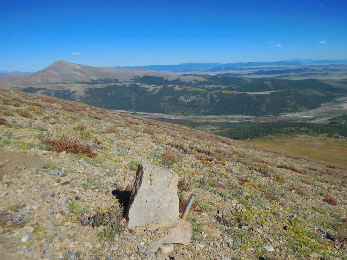

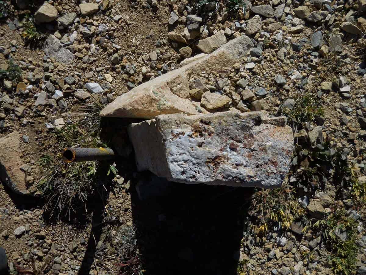

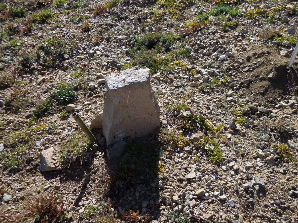

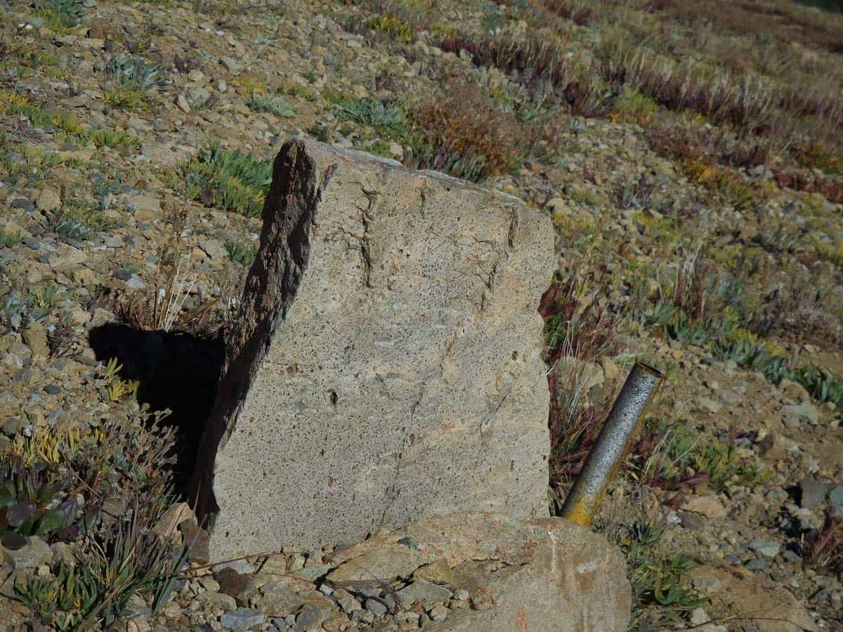

MightyMoe, post: 425866, member: 700 wrote: I've got lots of original stones with reference monuments. One guy would even dig in a nice brass cap at a 1' witness corner distance on a section line next to the stone.
I also find "reference" monuments as accessories to original stones. This pipe was driven only 4" into the ground. I found no record as to who set it. The pipe has a small patty of concrete to hold it firmly in place! At least it was a gorgeous fall day.
Cor. No. 1 of the Silent Friend Lode, MS 20504 (Mt. Silverheels to the left; Pikes Peak is the far mountain to the right)
Stone marked 1-SiF-20504
Chiseled "X" in center of top face
Posted : April 28, 2017 10:51 am
The pipe might qualify as a "braking device" to slow the stone's downhill slide. 🙂
Posted : April 28, 2017 11:12 am
It looks like the rock is armed with uh something LOL
Posted : April 28, 2017 11:19 am
Posts: 5732
I got $50 that says if you pull on the "pipe" the door opens to TDD's secret underground bunker.
Posted : April 28, 2017 11:41 am
Posts: 5732
Dave Karoly, post: 425908, member: 94 wrote: It looks like the rock is armed with uh something LOL
Is that a reference monument or are you happy to see me?

Gene Kooper, post: 425898, member: 9850 wrote: I also find "reference" monuments as accessories to original stones. This pipe was driven only 4" into the ground. I found no record as to who set it. The pipe has a small patty of concrete to hold it firmly in place! At least it was a gorgeous fall day.
I've got hundreds of those, it seems that surveyors can't help setting a piece of rebar or pipe next to a stone, I figure it's for help when it's snowy
