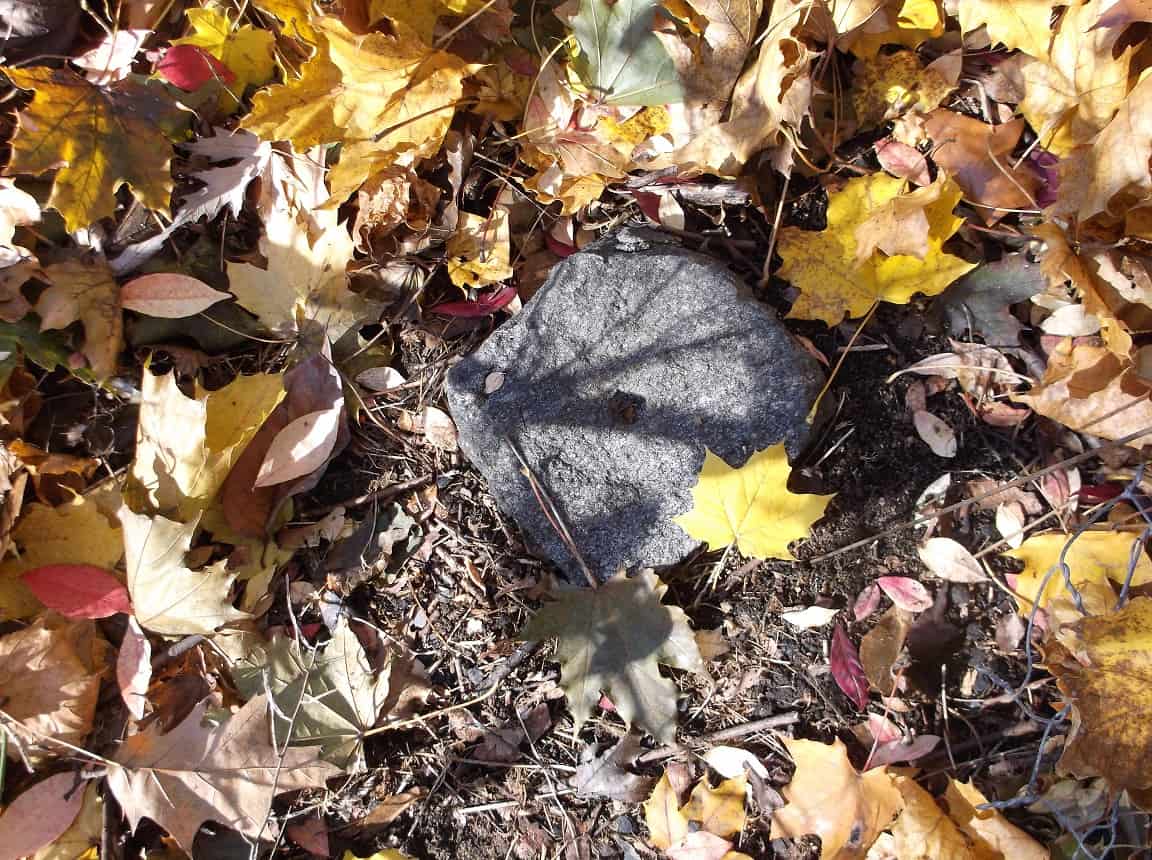

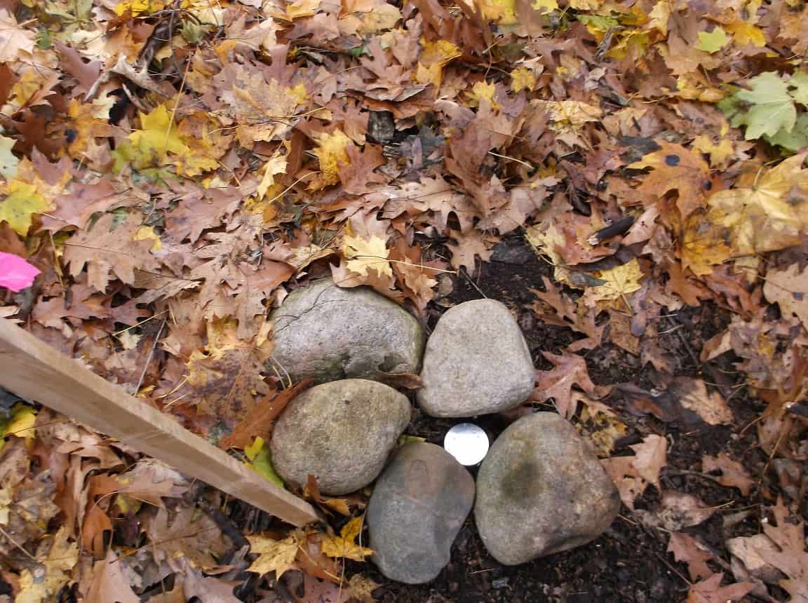

Perhaps the last survey project before the snow.
Here is a very good granite stone corner found circa.1870 and a corner set with a nice survey campfire surrounding it.
The set corner is a 5/8" or number 5 steel reinforcing rod that is three feet long with aluminum cap (disk?) bearing my name, license number and a punch mark.

3 feet? Wow, in this area, that would leave most corners sticking a foot out of the ground. 5/8 x 20" is fairly typical around here.
For a deformation monitoring survey in northern Canada, we did set 1-1/4"x6' solid iron rods...... In winter..... At ground level.... And set Lots of them......

The metal rod is long enough to be stable through twenty-five years according to the board rules. They don't specify a length, but, three feet is very tough to remove. It can be tough to install too. Sometimes digging to remove boulders that have inconveniently placed themselves where the rod is being driven.

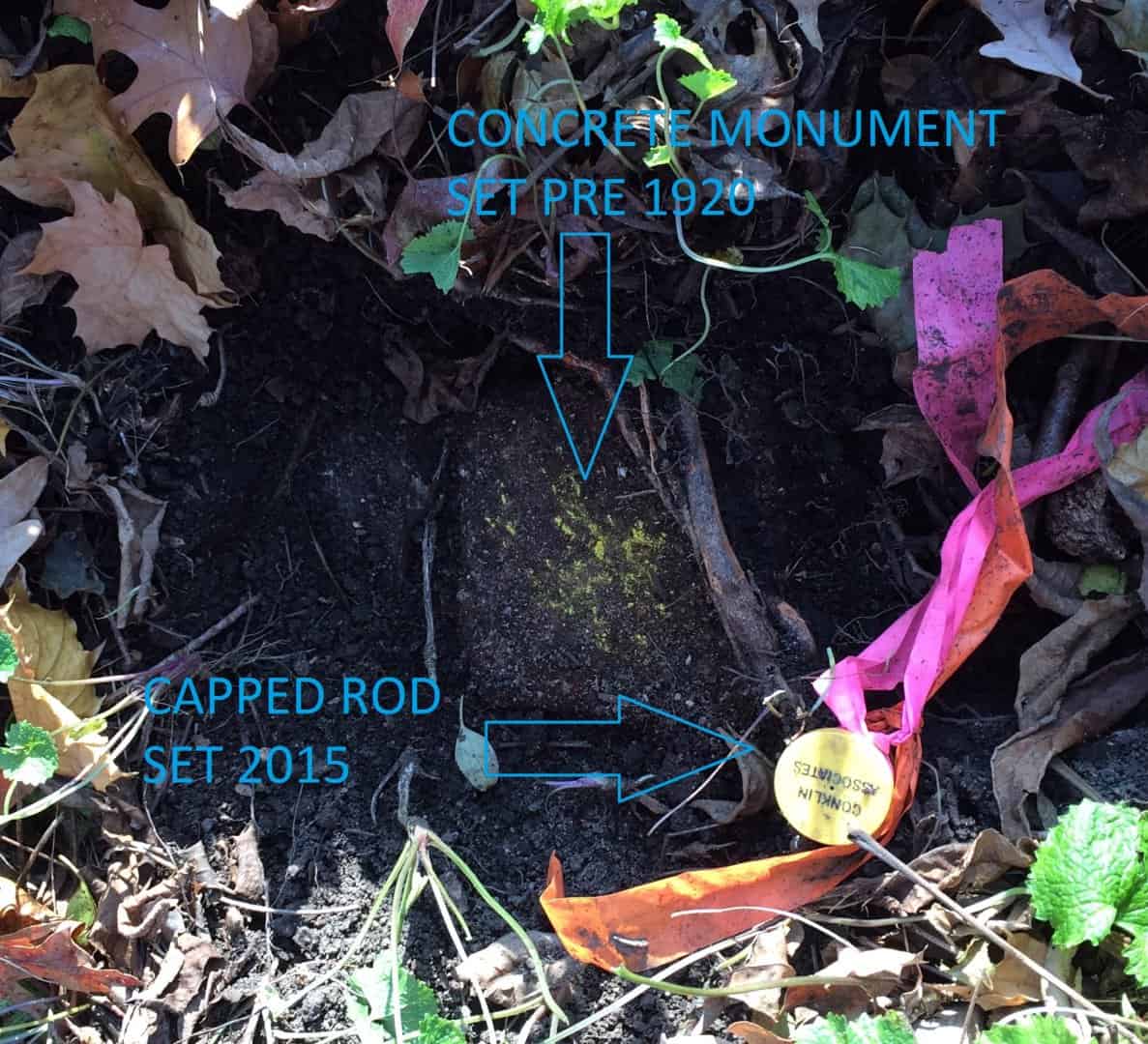

Didn't get a reading on the locator, so just set a pin. They're not getting paid to look around the area. I'll bet they even moved the pin a little because the point fell on the edge of a big rock!

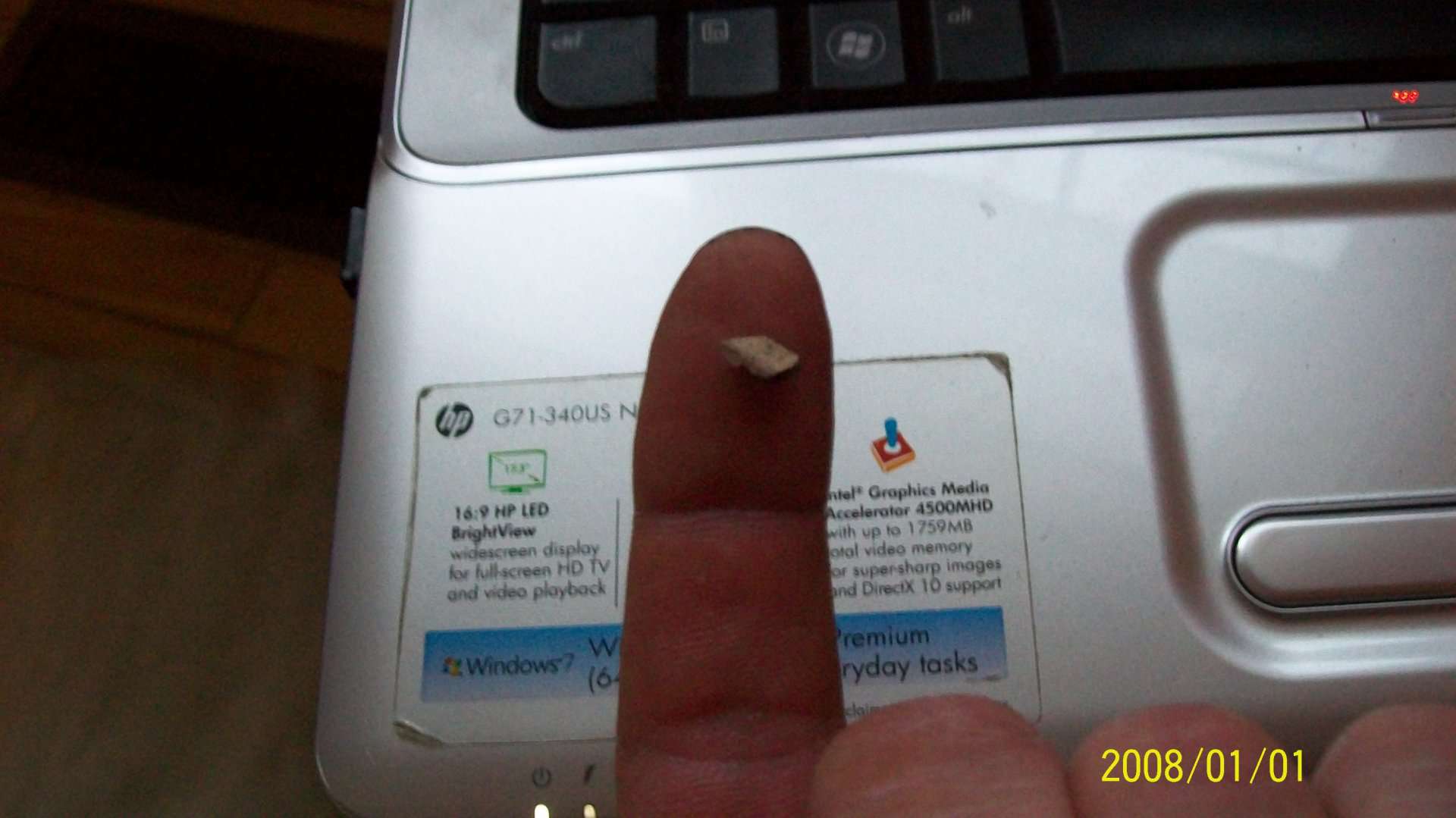

Spent close to a hour digging for this one day.
