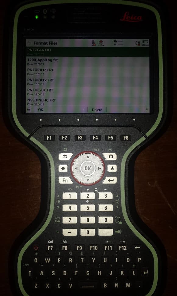

Hello everybody. My company recently switched to using Leica data collectors (Model CS 20, see photos). We are experiencing the following problem after taking the shot: although the code and description are put in correctly, when double checking the list of points shot (after saving the shot), we noticed that a lot of times the codes have not been changed and they're carrying the same description as whatever the previous shot was described as. I tried discovering if there is pattern to this error but so far I have been unsuccessful to figure out what might cause it. The manual does not mention anything helpful and the Leica representative doesn't know how to fix it either. This happens to 2 of the 3 collectors used in the field and while this post might be a shot in the dark, I was wondering if maybe some of you experienced a similar problem.
Thank you for your time, A.M.

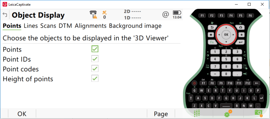

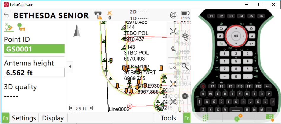

I had this happen to me in the V1 firmware, haven't had it happen since loading V2. I dealt with it by using the map screen and turning on the point descriptions. If the prior description stuck I could see it real time then edit the errors as they happened. Going to edit points after every shot would be super frustrating.

Cameron Watson PLS, post: 392856, member: 11407 wrote: I had this happen to me in the V1 firmware, haven't had it happen since loading V2. I dealt with it by using the map screen and turning on the point descriptions. If the prior description stuck I could see it real time then edit the errors as they happened. Going to edit points after every shot would be super frustrating.
Thanks for the idea. I have yet to figure out to have on display the previous point shot.

AlinM, post: 393508, member: 11332 wrote: Thanks for the idea. I have yet to figure out to have on display the previous point shot.
First make sure to use the zoom tool so the map tracks with you. That's the 2nd button up from the bottom on the right hand side inside the zoom tools.
The one with the 4 arrows pointing to the orange prism.
Then hit Fn Display at the bottom.
Here I would typically only have the first 3 checked to minimize clutter on the map. Good luck!
