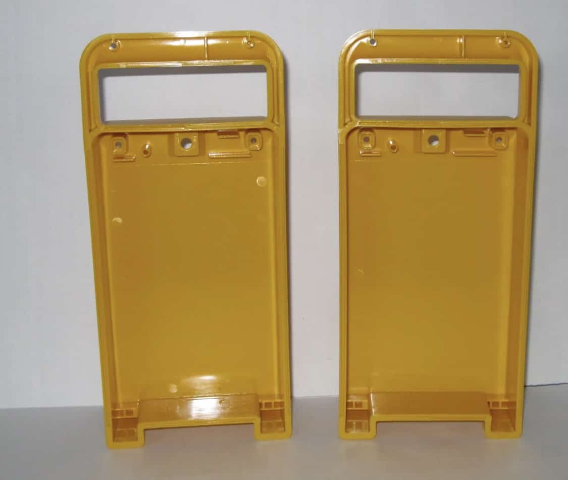

I am looking to get the inside dimensions of the Trimble cowbell battery case. Anyone know where I can get this information? I'd like to fit a 12v battery rather than buy a new one.

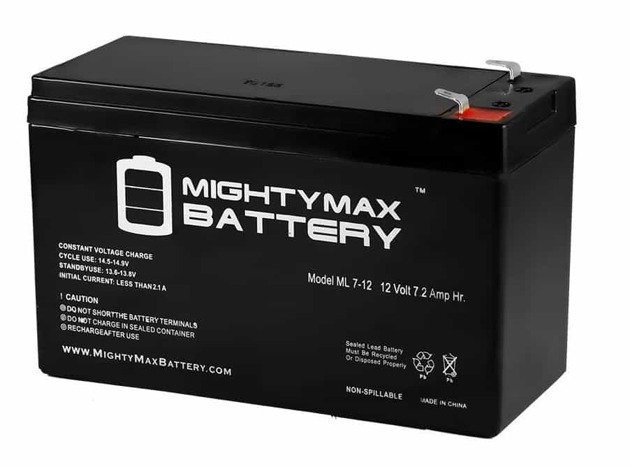

The cowbell takes a standard 7.2v SLA battery, the kind typically used in emergency lighting systems. There are one or two rubber pieces inside that pad out the battery to fit the case.

According to the battery pictured, that should read 12V 7.2Ah. That being said, if this is for GPS/GNSS receivers (and not including base external radio transmitters), the Trimble "clone" units that we use have internal "camcorder" type batteries that are 7.4V and the highest capacity ones that we have are 3.4Ah (the stock ones are 2.5Ah), so on that basis and assuming that the external power port can handle sub 12V, re-jigging a cowbell maybe could be done with LiPo, etc, configured for 7.4V, not 12V. (We formerly used these UPS type 12V 7.2Ah batteries to power a RTK base receiver + 4W external radio + solar but had continuous problems so now just use a small-car-12V-wet-cell-battery).

Richard Imrie, post: 448098, member: 11256 wrote: According to the battery pictured, that should read 12V 7.2Ah.
Yep, I typed that in a hurry and messed it up. 12v 7.2ah is correct. And I wouldn't use a cowbell to power an RTK base, either -- they were designed to power receivers, not transmitters.

My cowbell battery contained an Interstate brand that looked almost exactly like the picture above. It's easy to replace.
There are some variations in the sealed lead-acid battery construction. Supposedly the ones marked Deep Cycle should last for more discharge-recharge cycles than the ones intended for emergency light standby use where they expect to only see a handful of discharges over a lifetime of several years. There are also ones intended for uninterruptible power units where they can deliver high load currents for a short time, but those also may not last as many cycles.
I damaged my battery by running a session to exhaustion in freezing weather. Freezing weather is ok so long as you don't let it run completely down, but a discharged battery freezes and messes up the internal plates. I replaced it with a larger one in a plywood box to have more capacity.
Posted : September 24, 2017 8:06 am

Those 12-volt 7-Ah (sometimes a bit higher Ah rating in same-size case) batteries are available with spade-type terminals either 3/16 (0.187) or 1/4 (0.250) inch wide.
Some manufacturers designate the 3/16-inch terminals as F1 and the 1/4-inch terminals as F2.
The Trimble assembly uses the 3/16-inch terminals, make sure you get the right one.

Jim Frame, post: 448097, member: 10 wrote: The cowbell takes a standard 7.2v SLA battery, the kind typically used in emergency lighting systems. There are one or two rubber pieces inside that pad out the battery to fit the case.
Is that mighty max a Trimble original or an example replacement?
The "DO NOT CHARGE IN A SEALED CONTAINER" warning might be something to think about.

vern, post: 448125, member: 3436 wrote: The "DO NOT CHARGE IN A SEALED CONTAINER" warning might be something to think about.
I've put a variety of SLA batteries -- all aftermarket, mostly cheap Chinese -- in cowbell cases and haven't had a problem with hydrogen buildup. Maybe I've just been lucky, or maybe the Trimble chargers are slow enough that the batteries don't off-gas fast enough to exceed the case leakage rate.

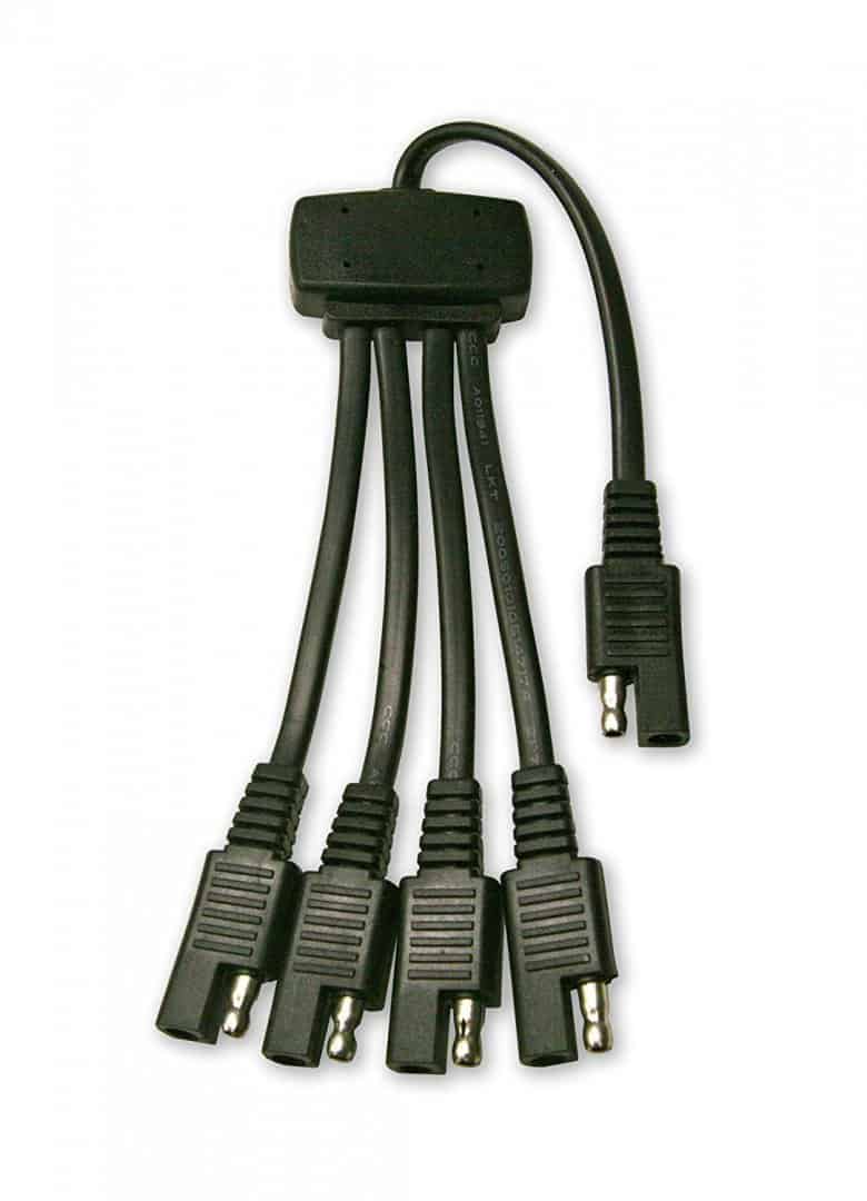

John Hamilton, post: 448200, member: 640 wrote: We buy trimble power cables that have ASE connectors on the end, and we put ASE cables on all of the batteries.
I've setup most of my power solutions to use that connector as well. I buy https://www.amazon.com/NOCO-ISCC2-5-Way-Adapter-Connector/dp/B003L643KS/ref=sr_1_2?ie=UTF8&qid=1506345608&sr=8-2&keywords=sae+connector&apos ;">these and cut off the 5 pigtails to make up my cables:
(The last time I bought some -- in August of last year -- they were $5.95, and now Amazon wants $10.62. I hate they way they monkey with prices.)
