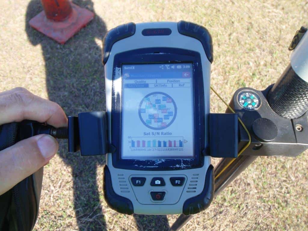

We updated the FW on our Trimble BD970 based RTK earlier this year and upgraded to SurvCE 5 to get the RTCM V3.2 so now have GPS, GLONASS and BeiDou running. Down this way (SW Pacific), this is what we get in RTK in open sky (typically 4 BeiDou out of the 19 "fix"):
Posted : September 24, 2017 6:21 pm

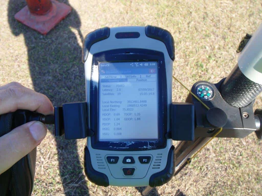

BTW in those photos I am standing next to the base but the latency is sitting on 2 seconds. I'm fairly sure that prior to the BeiDou upgrades (receiver FW and SurvCE software) the latency would have been 1. Has anyone else experienced this and/or know if it is an issue?
