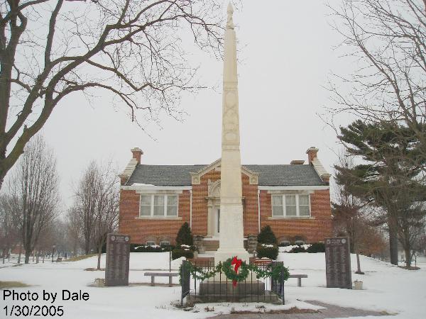

I'm wondering if this one would be suitable for GPS before the leaves come out.?ÿ It seems marginal at best.?ÿ It's on the base of the stone monument, and I expect the stone column would attenuate the signals somewhat, but probably not cause serious reflections because it is non-conductive.?ÿ Anyone with applicable experience?

Do the survey and use the report to decide if you like the results. Occupy for 6 to 8 hours.?ÿ

@Bill93 - that is a beautiful monument in an attractive setting.?ÿ
?ÿ
Where is that and is it a war memorial??ÿ I'm guessing World War I or earlier.

Tipton, Iowa, Civil War monument.?ÿ I haven't been to the site, but grabbed a photo from Geocaching.
https://www.ngs.noaa.gov/cgi-bin/ds_mark.prl?PidBox=MG0401
