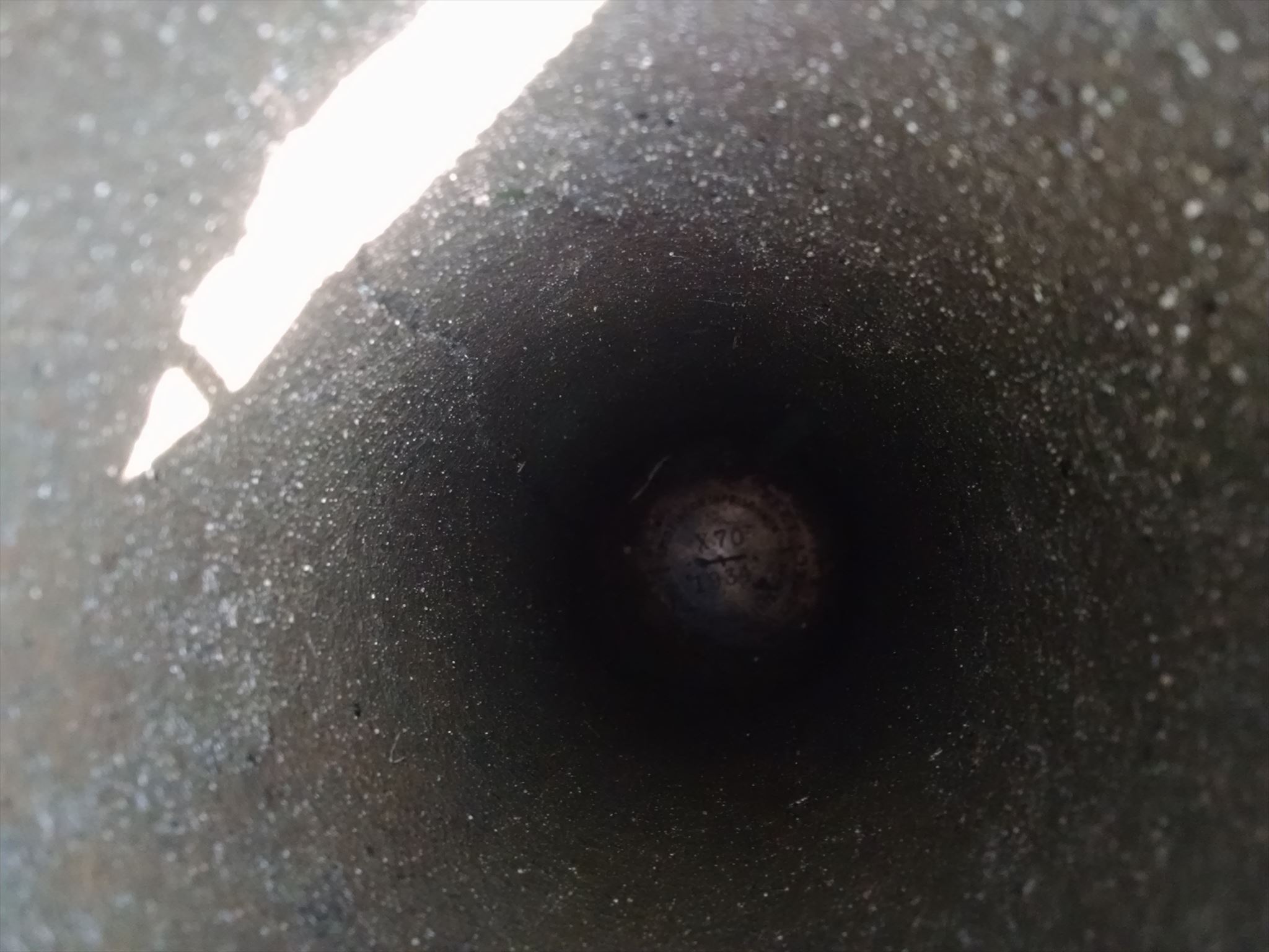

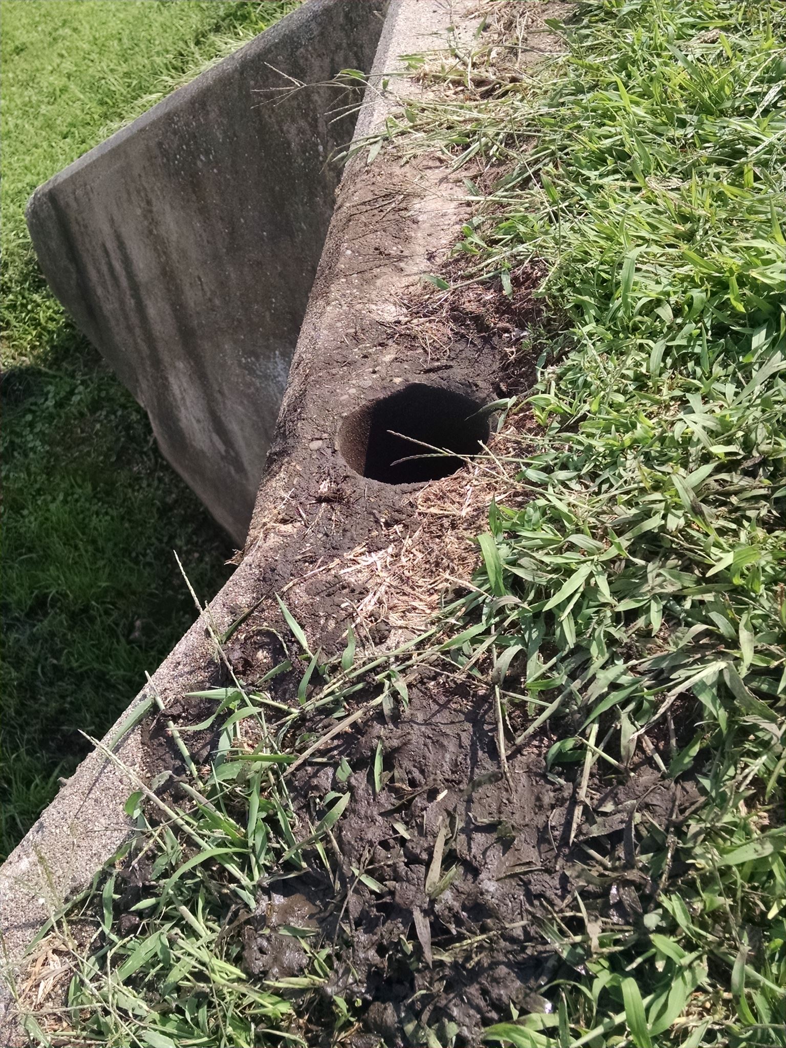

My brother recently filed a recovery on one that is an example of how to NOT place them.
"AT BOTTOM OF 4 IN SEWER PIPE WITH SCREW CAP, SET VERTICALLY IN CONCRETE HEADWALL."
The cap is now missing.
He cleaned out a foot of accumulated much to get this picture.
Posted : September 1, 2016 9:34 pm
