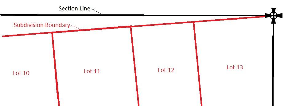

1960 ‰ÛÒ Ma and Pa Belly are deeded the east 825 feet of the NE 1/4 NE 1/4 of Section 16.
1966 ‰ÛÒ Plat of ‰ÛÏBelly Acres‰Û subdivides the east 825 feet of the NE 1/4 NE 1/4 of Section 16.
1976 ‰ÛÒ Another surveyor finds that the plat left a gap on the north boundary between the monumented plat boundary and the section line:
I looked this up in my 1986 copy of Brown‰Ûªs Evidence and Procedures today to refresh my memory and Brown indeed states that the gap is retained by the subdivider‰Û? the lot lines don‰Ûªt extend to the section line (the book is at work, so I‰Ûªm paraphrasing right now).
I was wondering if anyone has specific court cases that state this principle‰Û? or the contrary?

There is an Oregon case (can't find it just now, but I know it exists) in which the court states that the grantor could have had no intent to retain a tiny of sliver of land that could be of no use to them.
Posted : November 17, 2016 8:39 am
Do a search for 'strips and gores'. Escondido Servs. LLC v. VKM Holdings LP, Texas App. LEXIS 4260.
In short, the courts are unlikely to allow claim by the underlying owner in a useless strip not specifically reserved. It brings this problem in line with construing against the grantor...
Posted : November 17, 2016 8:54 am

I agree with Mark & Tom. If the intent was to make the north boundary of the subdivision coincident with the section line, then, chances are, there is no "gap".

This is the example from Brown, et al. where the subdivision should not be extended to the parent tract boundary (circles are found original corners). This does not look like what you are describing in your situation
Brown also states that that the principle of not extending the lines to the parent boundary does not apply in cases where the gap is insignificant, where the original subdivision monuments cannot be found, or where there is a presumption that the subdivision was intended to be all of the original parcel.
The section is written poorly because it seem to use an example that is an uncommon situation to establish a "principle" then caveats the "principle" by stating that it does not apply in 99% of the situations where a gap would be likely to seem to exist between a subdivision and the parent tract boundary.

Does the plat show a strip? I assume not. Then the intent was to go to the section line. My concern would be did Belly give up the land to the adjoiner, being the same thought as Dave what is the history of the section line/property line. That is, does the owner to the North have any claim to the gap? A lot of time has passed since the subdivision created the property line.

I'll answer with a question. Did the survey that laid out the subdivision survey the entire half mile and determine the section line? I would probably say no. He most likely survyed along some kind of occupation line such as a fence and called that the section line. At least thats the way they were done in my area. Surveyors get hung up on the idea lines have to be straight for a half mile. Maybe this created the so called gap in this case, or maybe not.
Posted : November 17, 2016 12:07 pm
Does the plat show the north line as being the section line? If so, that is the senior "call" on the subdivision plat. Like finding a pin, I would presume they meant for it to be the section line, and look for reasons to "not" assume they meant for it to be the section line.

Thanks for all the replies. For what it is worth, I don't have a dog in this semi hypothetical fight... another surveyor is pondering a somewhat similar situation and I mentioned the Brown take on this and figured I'd bring it to the brain trust to see if there's a pile of case law supporting it.
This example in Brown's "Evidence and Procedures", 3rd Edition, stuck in my craw in 1986 when I bought the book. Why would this mistake revert to the subdivider? A narrow uneconomic remnant strip returns to the subdivider for cultivating a couple rows of corn?
I think nowadays, with intent being key to how a lot of us puzzle through boundary retracements, it seems elementary that the mistake or inattention of the Belly's surveyor 50 years ago shouldn't put the Belly heirs and assigns back in the real estate business. Ma and Pa intended to divide up and sell all their land.

I agree Mike. To me the answer rests within the OP:
In my opinion the East 825 feet was platted, not a portion thereof. And the 1976 survey neither "found" nor "created" what he apparently perceived as a gap. Without any additional info I might be inclined to think the 1976 surveyor was too stuck on math and (probably) published distances. Resolving the boundary would definitely require a lot of evidence and insight. One paragraph in a reference book does not a rule make.

I think perhaps you should read a little further in Brown. I don't have the 1986 edition but In Chapter 5 of the 2nd Edition (1969) of Boundary Control, at page 193, the following Principle appears:
Where the original subdivider failed to subdivide all his land as shown by found original monuments, do not extend the lot lines beyond the limits of the original monuments. Title to the unsubdivided land remains in the original subdivider.
Which, no doubt, is the Principle which you refer to. This is followed one paragraph later with the following amendment: The rule cannot apply to small insignificant errors or cases where the original subdivider's monuments cannot be found. He then goes on to mention a Washington case involving a 4-1/2 foot wide strip as an example of what might be considered insignificant.
