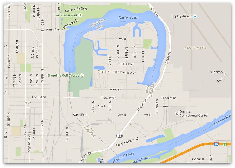

Nate The Surveyor, post: 410551, member: 291 wrote: Part of Arkansas, is east of the Mississippi, for this very reason. Somebody can post a pic.
Carter Lake Iowa is west of the Missouri River for this reason too...
