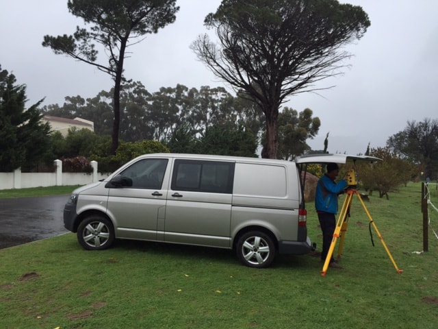

We carry two good quality golf umbrellas that can handle wind gusts, as we get horizontal rain here when the cold fronts roll in off the south atlantic, have a guy shield the robot and another guy follow the controller and prism pole.
I find that its the touch screen on the controller that is the real weak spot in the system, as it becomes pretty unresponsive when water is running over it, also the water drops on the prism make it harder to track , and we lose lock often.
Having two extra guys to lug the umbrella's is not efficient, but the main contractor provides them, I just tell them, if you want it staked in the rain, you provide the extra manpower, or we will come back when it stops....
Sometimes we just set up under the rear flap of the 2.0 l TDI VW crewbus like this
