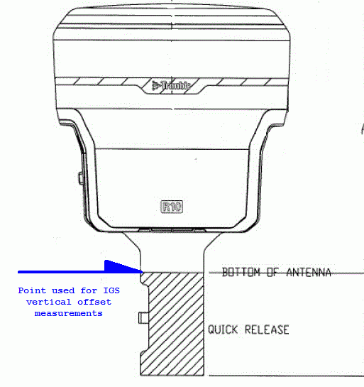

I've been using files collected with the R8-3 for submission to OPUS, but need to submit some files collected with the R10 and I'm not 100% certain of the measure up point on the receiver used with the NGS model. Anybody know for sure? Not having much luck finding it on the NGS site. Thought there might be past thread on it but no luck in finding it.

Bottom of the receiver. If you're using the QR add 5cm - so the R10 on a 2m fixed height with the quick release is 2.050m.

Also remember if you are using the slant measurement to side of the GPS head to calculate the correct height to the bottom of the antenna. Should have all the info on the https://www.ngs.noaa.gov/ANTCAL/&apos ;">NGS antenna data or from the manufacture site to use Pythagorean theorem. It is only a little difference, but isn't that our job?

Williwaw, post: 452133, member: 7066 wrote: ...I'm not 100% certain of the measure up point on the receiver used with the NGS model. Anybody know for sure? Not having much luck finding it on the NGS site.
From the NGS AntCal site, see Trimble antenna model TRMR10.
Current NGS/IGS policy is to use a non-detachable point for the ARP.

I just submitted two OPUS files through a TBC job, downloaded the receiver file then sent it to OPUS two different times. The only change I made was to change which measure point I used. One to the lever arm, one to the bottom of antenna. I did no calculations or changes except when I sent it in with the lever arm, then I put in my measurement, Trimble converted everything for me and I got the same number from OPUS for the elevation for each submittal within .001m. If you have TBC it speeds up the process by using the processing services pull down menu.
The options for an OPUS submittal are:
Bottom of antenna mount
Bottom of quick release
Lever of R10 extension
Bottom of V10
Lever of V10 extension
Antenna phase center
Posted : October 24, 2017 3:47 pm
Posts: 3465
You should specify that those are TBC options, in all cases it will convert to the ARP, which is what OPUS REQUIRES. But it is a great feature that TBC will do that.
