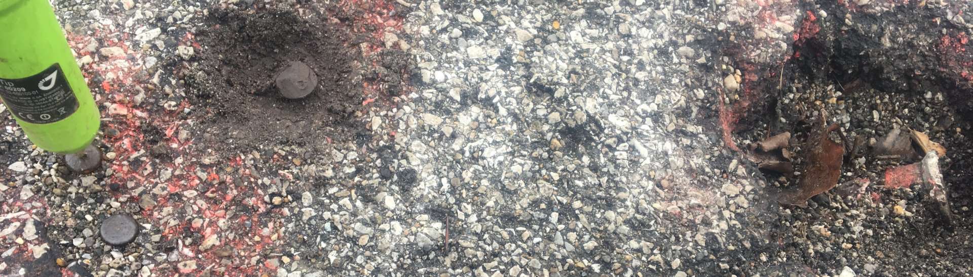

I hate finding things like this.

Might as well pound yours in there too, (wherever) It will drive future surveyors nuts. That is, if there are any future surveyors that actually look for corners. 😉

What I normally do in a case like this is take an average of the postions of all the monuments and set a new one. I just make sure mine looks newer and has a fancy cap so everyone in the future uses it.
Actually what I do is pick one of the monuments and use it and call out the location of all the others. Stuff like this will drive you nuts.

If you want yours to be honored make it look oldest, not newest...;^)

Guess I just don't see the problem. Plenty of room for new additions seeing as rehabilitating the original is out.

Ya know, if you run a skid steer bucket across there a couple of times, you wouldn't see all those bits anymore, and could start fresh....

In the middle of the three mon's on the left, set a 2" brass cap stamped with a LARGE "?" in its center...

The thing on the right is laying down, so is disturbed and probably came from the area to the left. That leaves a couple of nails and a larger rod. The nails were probably placed by people who didn't find the shallowly buried rod. Lacking any other evidence, I'd go with the larger rod near the top of the picture. Especially so if it fit measurements well.
