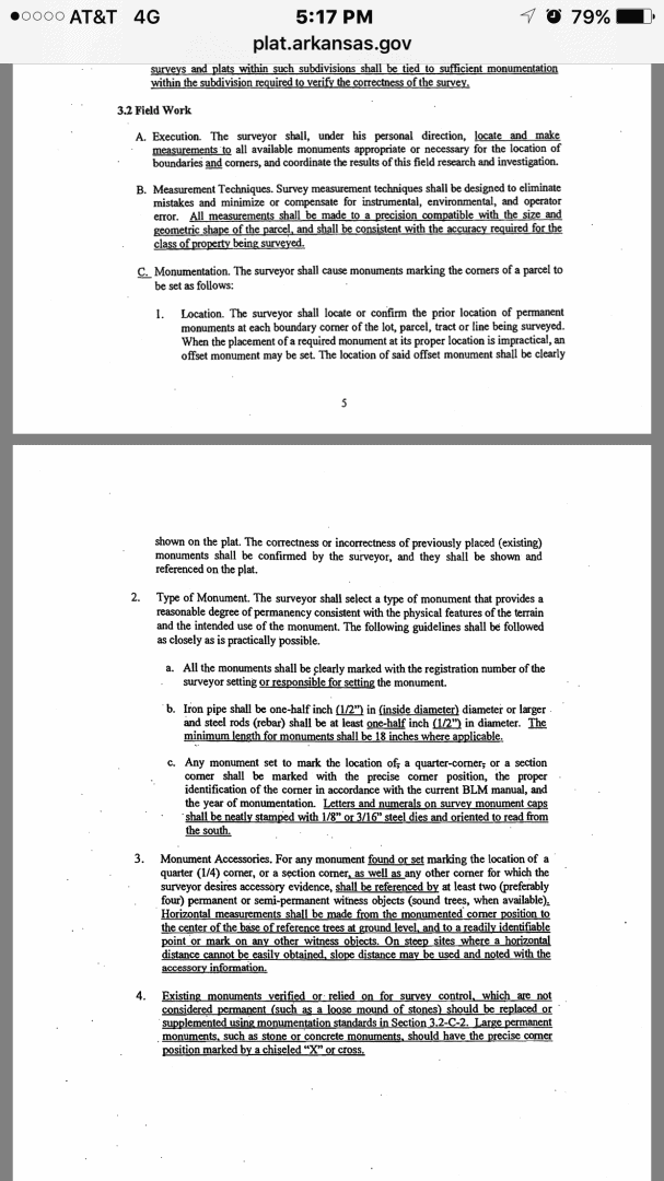

The thread that has worn thin on opinions about monuments in Texas encouraged me to seek out how some other States define monuments in their statutes. The following excerpts are taken directly from unnamed States.
Monuments. The type and position of monuments
to be set on any survey shall be determined by the nature of
the survey, the permanency required, the nature of the terrain, the
cadastral features involved, and the availability of material
A Boundary Monument is an object found or set on a boundary line which preserves and
identifies the location of the boundary line on the ground.
Every boundary monument set shall:
a. Be composed of a durable material;
b. Have a minimal length of 18 inches;
c. Have a minimum cross-section area of material of 0.2 square inches;
d. Be identified with a durable marker or cap bearing either the license number of the surveyor in responsible charge, the certificate of authorization number of the business entity; or name of the business entity;
e. Be detectable with conventional instruments for finding ferrous or magnetic objects.
f. When a corner falls in a hard surface such as asphalt or concrete, alternate monumentation may be used that is durable and identifiable.
The corners of lots, tracts, other parcels of land, aliquot corners not described in
subsection (?) of this section, and any line points or reference points which are set to perpetuate
the location of any land boundary or easement shall, when established on the ground by a land
survey, be marked by reasonably permanent markers solidly embedded in the ground.
A monument or reference monument set by a professional land surveyor shall
conform to the following categories and shall meet the following criteria:
(a) "Typical and Preferred" an iron rod, iron pipe, or iron pin that is:
1. Not less than one-half (1/2) inch in diameter and eighteen (18) inches in
length;
2. Equivalent to, or greater than, schedule-forty (40) weight if pipe is
utilized; and
3. Identified with a cap bearing the license number of the professional land
surveyor under whose direct supervision the survey was performed, and
which cap does not display any other license number.
(b) "Non-typical" to be used only when it is not practical to set the monuments
described in subsection (a) of this subsection, and that:
1. Preferably contains a ferrous material or is otherwise capable of being
located with a magnetic locator, and may include P. K. or mag nails at
least one 1 1/2 and one-half inches in length; and
2. Is identified with the license number of the professional land surveyor
under whose direct supervision the survey was performed, and does not
(c) "Alternate" to be used only when it is not practical to set the monuments
described in subsections (a) and (b) of this subsection and may include railroad
spikes, mine spikes, cross-cuts, chisel cuts, drill holes and curb notches, and
shall be referenced to a durable, physical feature.
1. Steel rebar: å? inch diameter or larger, a minimum of 18‰Û long with properly
stamped survey cap.
2. Steel pipe: å? inch inside diameter or larger, a minimum of 18‰Û long with properly
stamped survey cap.
3. Concrete markers: minimum of 4 inch diameter or 4 inch square, a minimum of
18‰Û long and buried in the ground, with a rebar or metal pipe cast within and
properly stamped cap encased in the concrete.
4. A drill hole, or a clearly scribed or chiseled mark, in existing concrete or stone.
This shall only be used if it is impractical to set a prescribed ferrous-based
monument. If it is necessary to use this type of mark, it must be clearly and
descriptively identified as to location and character in an accompanying report,
map or on the face of a plat document.
5. A hardened, and preferably magnetized, steel spike driven through a washer
properly stamped with the Land Surveyor's license/registration number and
recessed into a paved surface or similar location where a prescribed monument
is impractical
Natural objects chosen for monuments shall be durable, unique and easily identifiable.
Set monuments shall be durable, reasonably stable and firmly placed, able to maintain its
position when subjected to extreme temperature changes and other severe weather conditions, able to be located
with current or future technology and have the following dimensions:
Iron or steel pipes shall have a minimum inside diameter of one (1‰Û) inch and a
minimum length of thirty (30‰Û) inches, when feasible;
Reinforcing rods (rebars) shall have a minimum outside diameter of five-eighths
(5/8‰Û) inch and a minimum length of thirty (30‰Û) inches, when feasible;
Other artificial markers shall have a minimum cross-sectional area of one-half (1/2)
square inch and shall be made of durable material
Posted : November 18, 2015 10:28 pm

1111
 1111
(@surveyor-in-training)
Posts: 38
Arkansas
Posted : November 19, 2015 5:22 pm
