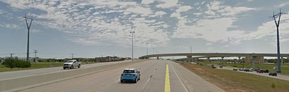

Got a power transmission line project coming up where intersecting cross power lines will need to be measured up for height of wire. Looking for ideas on quick ways to obtain power transmission wire heights.
Thanks for any ideas.

Height rods are good for backyards and county back roads (where I prefer working). Some of the stuff I measure is Interstate highway and in the neighborhood of 40 to 50 feet in the air.
