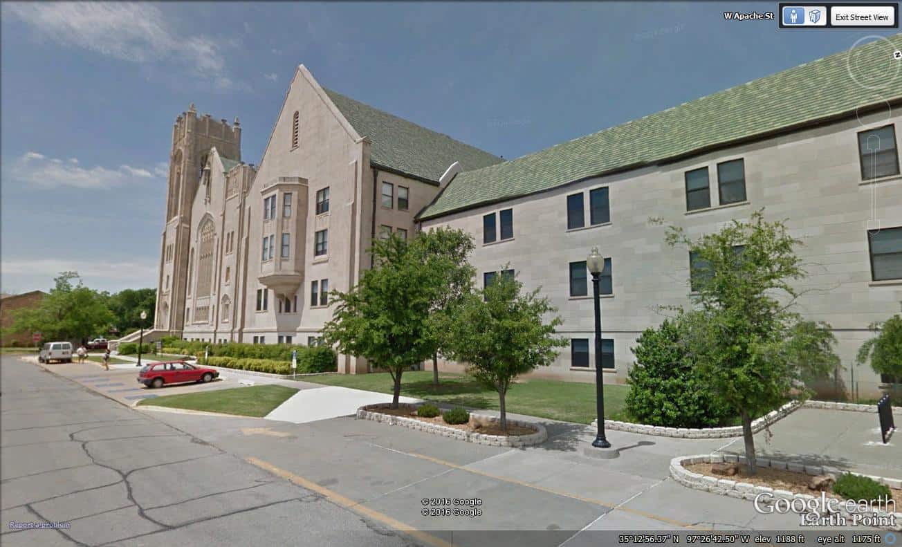

I just remembered a story about a structural survey done here in town about 16 or 17 years ago. It might be funny unless you worked for the survey outfit that did the survey.
The McFarlin United Methodist Church sits 2 blocks north of the University of Oklahoma. Built in 1925 it was a premier architectural achievement. It is a beautiful renaissance style structure and I listen to the bells every day.
The original sanctuary and building is on the left of this pic. The building from about mid-frame to the right was added on in 1998-1999 and one of the "big boy" consulting firms around here was contracted to perform an in-depth survey for the planning of the multi-million dollar addition. One thing the architect was adamant about was precise elevations of the joints in the huge limestone blocks on the existing structure. Blocks were going to have to be quarried (at a great expense) to match and the architect wanted the masonry to "flow" seamlessly.
The outfit did a great job on the survey...except they busted the elevations on the existing limestone blocks, by about 0.25'. This wasn't discovered until the basement, foundation and grade beams were in place on the extension and the walls were fixing to go up.
I understand it cost the surveyors a tidy sum to "make things right"....

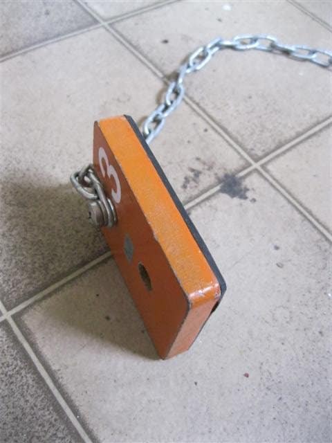

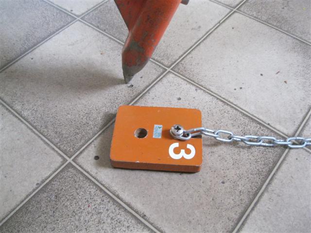

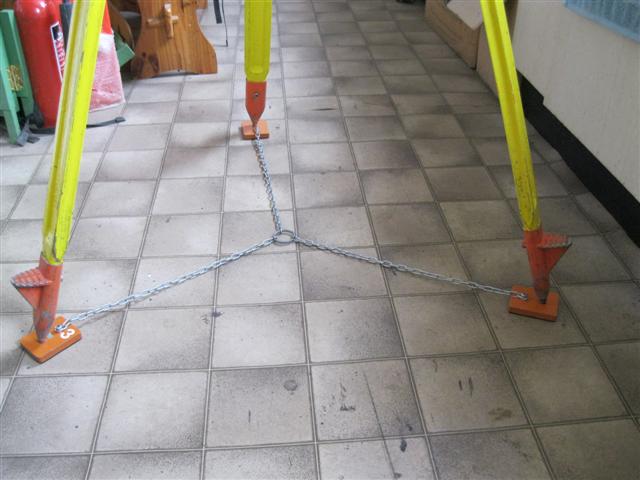

As promised, views of a tripod support I made (four in total so that traversing can be carried out on smooth surfaces).
The pads are from plywood, 12mm. thick and about 9cm x 6cm. The leg hole was drilled at 12mm, but stopped JUST as the point of the drill broke through, so there is a nice tapered socket for the leg point to sit in. The bottom is 3mm. neoprene sheet, stuck on with a rubber contact adhesive. Chains are galvanised from the local do-it-yourself store. The neoprene will slide easily if the weight is taken off, but grips very well once the load goes back on. this makes it easy to adjust the tripod position for centring but ensures it stays put when observing. They were made about 10 years ago, so have had plenty of use and no problems.
I suppose if you wanted to produce a really class job you would drill the legholes on a rake to match the tripod legs.

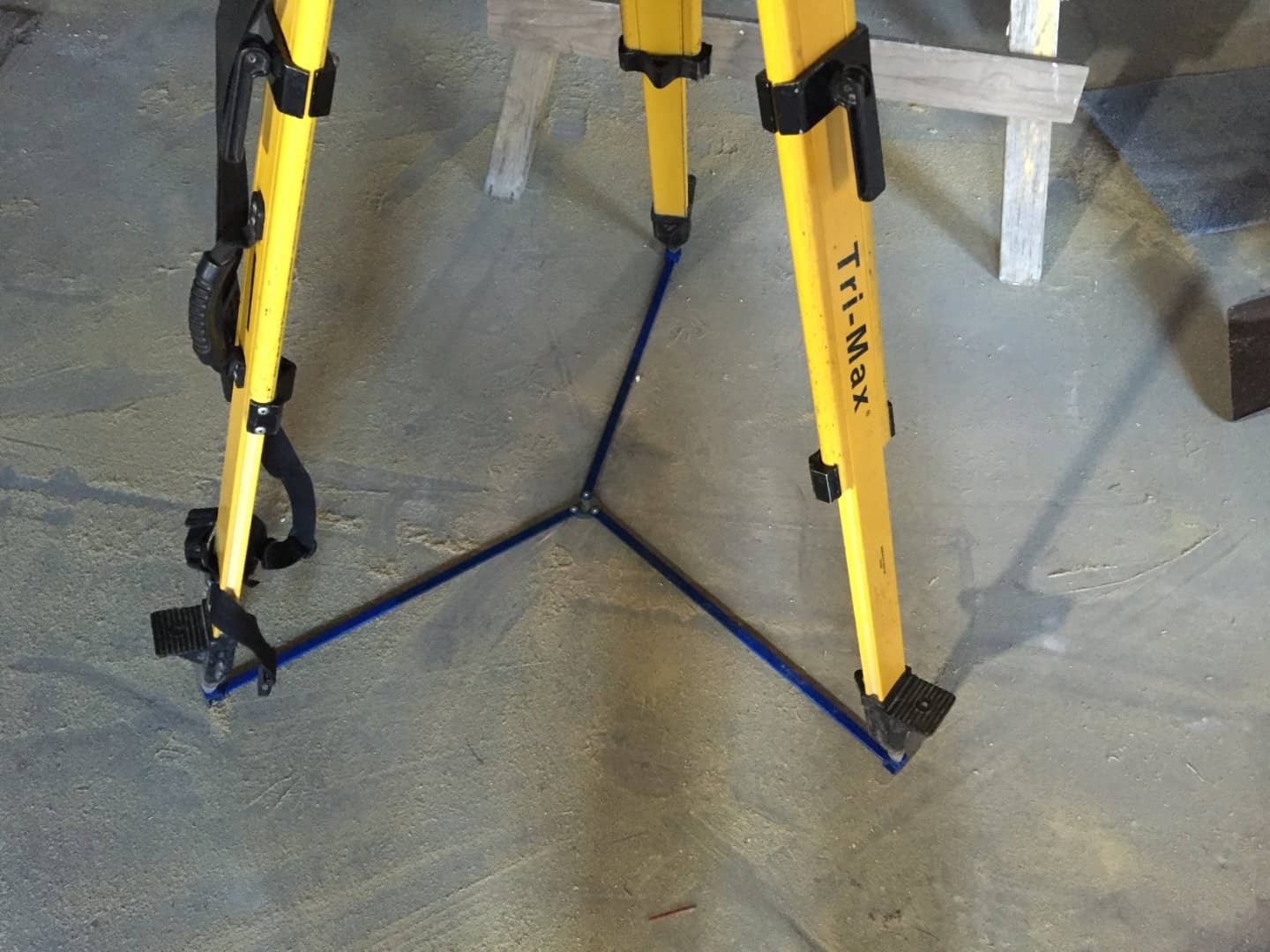

This is what we have which is pretty simple too. There is a central large washer attached to three pieces of flat bar which have small portions of square bar welded on the end. Each piece of square bar has a hole in the top for the leg tips. Each arm swivels about the rivet that holds it to the centre circle so it packs down nicely. One advantage of yours though is that it would be able to be used on uneven floors.

Seb, post: 378891, member: 7509 wrote: One advantage of yours though is that it would be able to be used on uneven floors.
That's exactly why I made it that way, rather than buy a standard one with fixed bars. You can also pull the feet sideways, so it doesn't have to form an equilateral triangle - useful in tight corners.
The chains will grip quite well, even if they pass over cables and other obstructions. a small downside is that the leg length is fixed.

Seb, post: 378891, member: 7509 wrote: This is what we have which is pretty simple too. There is a central large washer attached to three pieces of flat bar which have small portions of square bar welded on the end. Each piece of square bar has a hole in the top for the leg tips. Each arm swivels about the rivet that holds it to the centre circle so it packs down nicely. One advantage of yours though is that it would be able to be used on uneven floors.
I have similar setup except mine connected with small chains.
