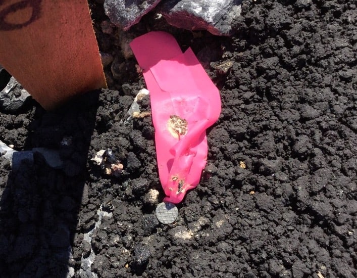

Surveyors are perpetual cobblers, re-purposing stuff all the time. They are also cheapskates.
And...
They are also habit prone.
And buried flagging can last a long time.
So...
ANY nail, with flagging, tied, or poked through, or a noose on the nail, it's probably been placed by a surveyor.
I found a surveyors nail, last wk, that was probably 30+ yrs old... 0.05' from where a pin was supposed to be... Still had the flagging.
It was maybe where they ran out of rebar...
Flagging is pretty good evidence.

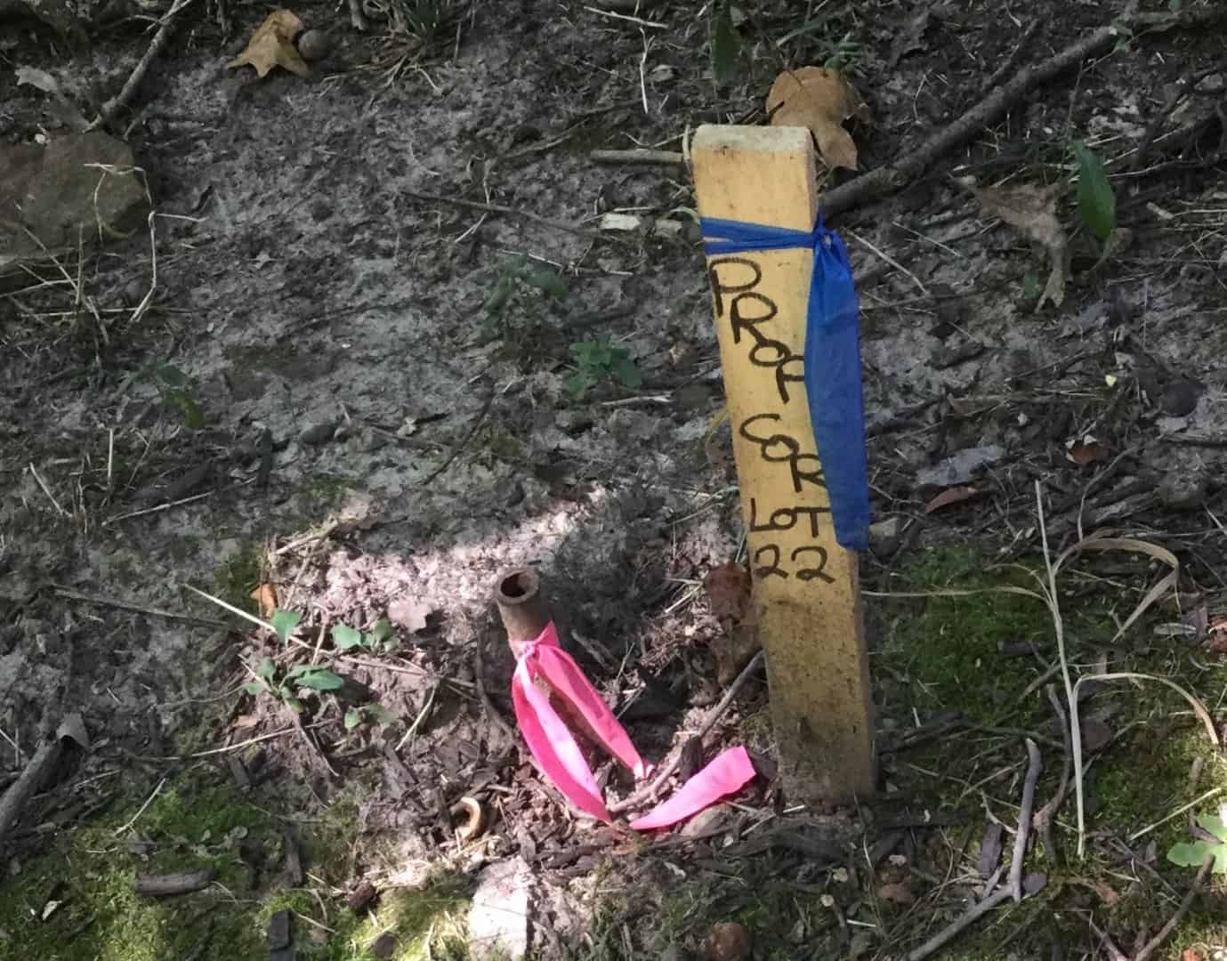

Another thing; do the colors of flagging have different meanings? Or are they just random. Because typically when I set control points I either use orange or pink. With Property Markers, pink, blue or sometimes both, so I'm really never sure what colors mean which.

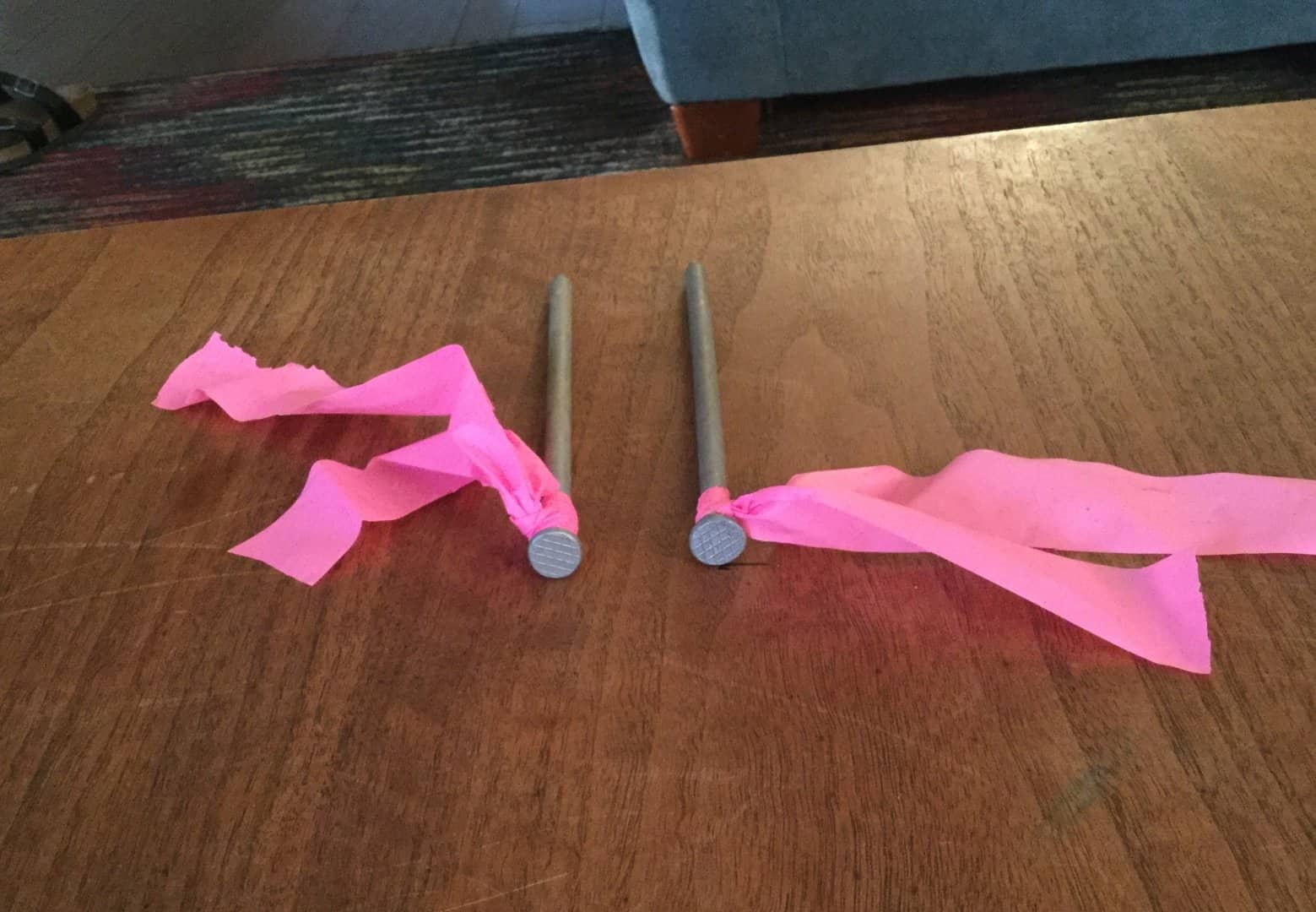

Also thank you to everyone who helped me find out that it is indeed a 60D Nail. I was able to pick some more up at my local hardware shop and tie some pink flagging to it

Local traditions only, I like blue and white for boundary, red white and blue for bench marks and pink for survey control.
Posted : September 24, 2017 5:32 pm
Crashbox
(@crashbox)
Posts: 545
The agency I work for (WSDOT) has certain colors assigned for various tasks. Yellow for centerline, blue for drainage and slope stakes, red for R/W, white for clearing/grubbing and electrical, green for sanitary sewer, multiple colors for references. For easements and miscellaneous details such as orientation stakes or nails for large, circular catch basin covers- I use red/white polka-dot flagging which is non-standard.

Just set some new 60D's out in a field for an offset. Here's one of them

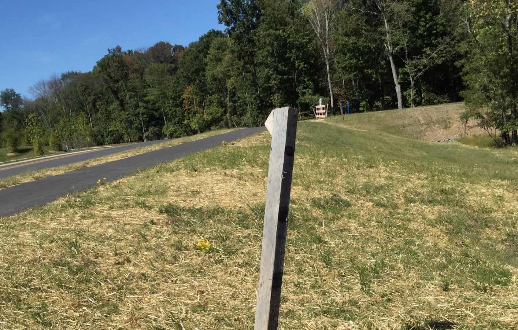

I also did see some odd boards sticking up from the ground in the general vicinity with trianglular shaped pieces of wood nailed into the sides. I don't know if they were related or not, because some of the arrows pointed In the general direction of some MAG nails set in the curb
Posted : September 25, 2017 10:16 am
kjypls
(@kjypls)
Posts: 312
RobertMS, post: 448243, member: 13052 wrote: I also did see some odd boards sticking up from the ground in the general vicinity with trianglular shaped pieces of wood nailed into the sides. I don't know if they were related or not, because some of the arrows pointed In the general direction of some MAG nails set in the curb
boards sticking out of the ground may indicate a water valve/well/gas/ect
Posted : September 25, 2017 5:47 pm
RobertMS, post: 448243, member: 13052 wrote: I also did see some odd boards sticking up from the ground in the general vicinity with triangular shaped pieces of wood nailed into the sides.
These generally indicate a 'stub-out'. They use the 4x4's that the pipe was delivered on, so the triangular shaped pieces are there to keep the pipe from rolling off.

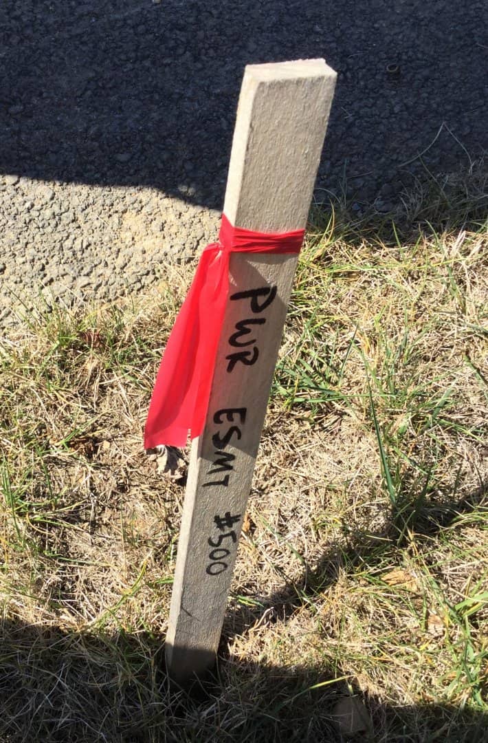

I never really associated the Utility Locate colors with survey flagging uses until I came across a lath stake for an electrical easement that used red flagging (again, same area as before).
