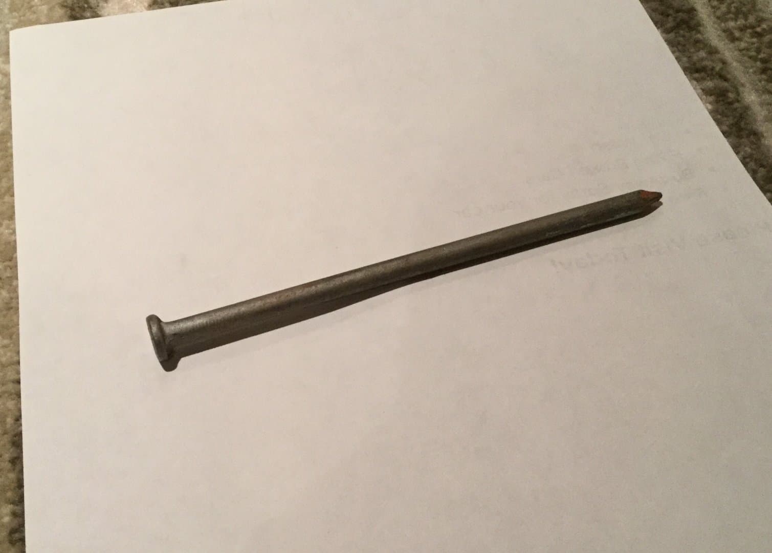

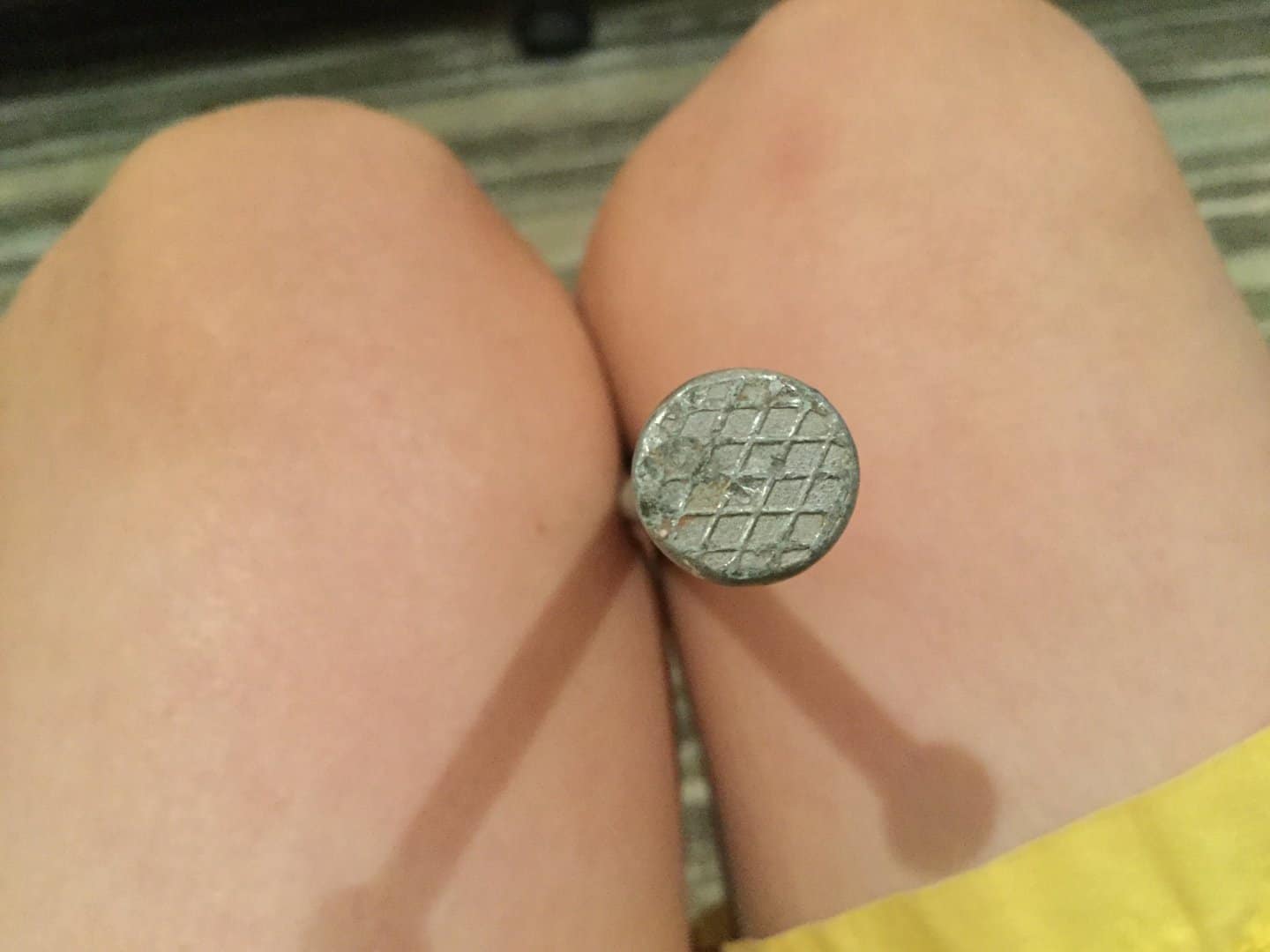

Hello all,
Since I am fairly new to surveying, there are some things I am still unsure about and cannot seem to get answers on.
For starters, I am familiar with MAG nails, but I recently came across some 6-inch survey nails that I seem to find useful for driving into the dirt, but I cannot seem to find out what kind they are or who makes them. They are 6 inches long and have a diamond/checkered pattern on the head.
Images below:
Posted : September 23, 2017 5:41 pm
I use 60d galvanized nails that fit that look and description.

Take a look at the Baseline Equipment website, they have a good list/images. (By the way, in the first image, is that fingers or knees?)

Posts: 26020
60d nails most likely. We use them routinely for a variety of purposes.

Ordinary 60d (ie/ "60 penny" nail, 6" long) nail, available for purchase at your friendly neighborhood big box hardware store.
Note: the "d" stands for denarius which was a small roman coin. The number represents the number of pennies a hundred such nails would cost, once upon a time.
Posted : September 23, 2017 9:36 pm

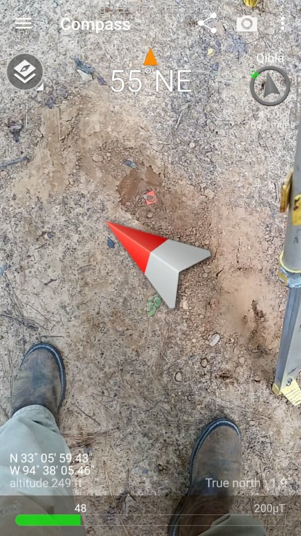

60d hub set in 2001half foot down in county road at entrance to driveway easement and found a few weeks ago.
That and 2 more points from original traverse made quick work of 70 acre survey.
Posted : September 23, 2017 10:42 pm

Richard Imrie, post: 448076, member: 11256 wrote: Take a look at the Baseline Equipment website, they have a good list/images. (By the way, in the first image, is that fingers or knees?)
Thanks.
Yes, it is my knees.

RobertMS, post: 448108, member: 13052 wrote: Thanks.
Or boobies?

A Harris, post: 448093, member: 81 wrote: 60d hub set in 2001half foot down in county road at entrance to driveway easement and found a few weeks ago.
What App did you use to get that?
Posted : September 24, 2017 10:30 am
Smart Compass Pro v2.6.6 from Smart Tools
