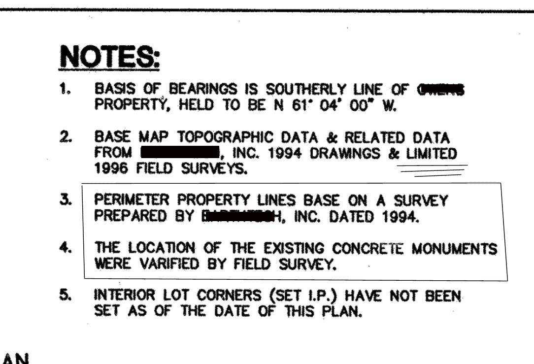

Here's a note for you: "Based on a survey by someone else." This plan was based on a previous survey by others: What if the others were displaced? How did you verify that with limited work? You can't blame an error on the previous survey if it's found you've perpetuated it. Also, the plan states clearly that the interior corners are "Set IPs" but the note says that none were actually in the ground at the time of the plan. I haven't found any yet either.
This particular project, like most all the others, involves a dispute over the location of a common boundary. "My line, as surveyed, is over here but it should be over there about 30 feet." There's apparently a no-man's-land in between and this fella thinks he should get it.
I'm wondering if he got his money's worth out of the '94 survey which was then perpetuated by the '96 subdivision of a possibly mis-located parcel of property next to the property I'm surveying. The money he saved can now be invested in an action to quiet title.
