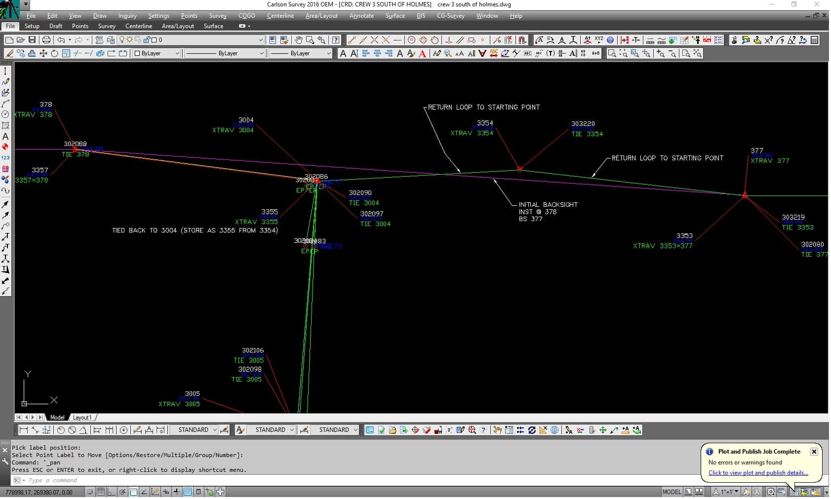

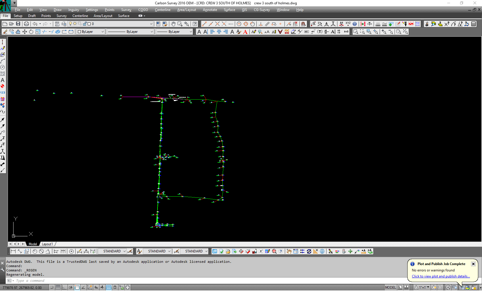

Thanks for all of the replies. As it turns out, after I posted this, I looked at the raw data more, and they actually ran through thier initial backsight point, and then added a few intermediate points between his initial backsight, and a point he used to run south along a road.
Here is a picture of the entire loop
Here is an image of the area where the Party Chief made his error. They are out there now turning a set of angles between 377 and 378 to "close the loop".
The PC initially set up on 378, BS 377, and turned sets of angles to 3004, and then proceeded to locate the road and run south. As they came back around, they ran through 377 (stored as 3353), and instead of turning sets of angles back to 378, he set 3354, and then occupied it, and "closed into 3004 (stored as 3355), and then turned sets of angles to 378 from 3355. He should have set on 3353, and turned sets of angles directly to 378, and he would have been okay. The geometry isn't that good for that last angle, but it is a tight corridor.

I will say that they did turn sets to another point running south from 3355, and I "could" close the loop that way, but I need those angles from 377 to 378. Those points came off of another adjusted loop that was ran along the road along the north line of this traverse.

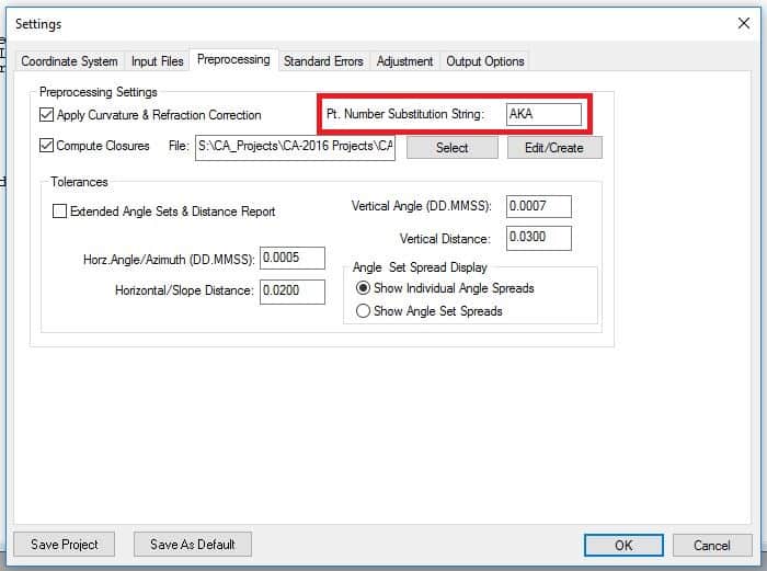

If you are using Carlson, which doesn't allow you to call a point what it really is after you have already observed it once, you can use the point number substitution string in Carlson SurvNET to take care of that.
Let's say you are closing onto point number 337, but your next available point number is 3353 to store, just call it AKA337 in the description and SurvNET will make the substitution and will not create a point 3353 in the coordinate file that just clutters things up.
