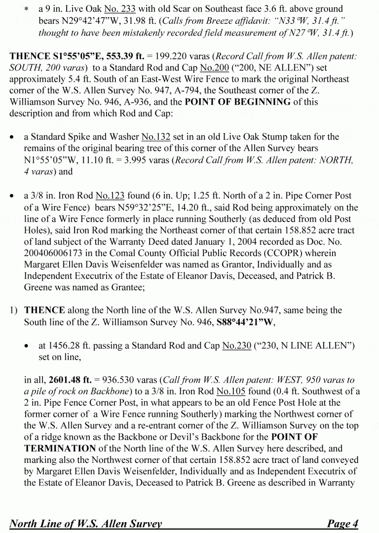

Sure, of course I check my own work. There's a step-by-step procedure that I use, proofing the whole description several times using different criteria on each pass to catch things that require revision or correction. I don't use an automated description writer, so the proofing even includes running a closure check on the courses and distances from the description.
Providing the geodetic coordinates of all points connected by the description, identified by point number that is also given in the description has simplified/eliminated quite a few sources of error.
Writing metes and bounds descriptions in outline style also makes them quite a bit easier to proof.
Posted : October 12, 2015 9:51 am
Kent McMillan, post: 340142, member: 3 wrote: Writing metes and bounds descriptions in outline style also makes them quite a bit easier to proof.
Here's a snippet of what I mean by "outline style":
Posted : October 12, 2015 12:47 pm
Here's an example of what I mean by "outline form":
FN_Example.pdf (11.6 KB)
Posted : October 12, 2015 12:56 pm
And here is a snippet of what outline style looks like (with the margins trimmed):
Posted : October 12, 2015 1:05 pm
