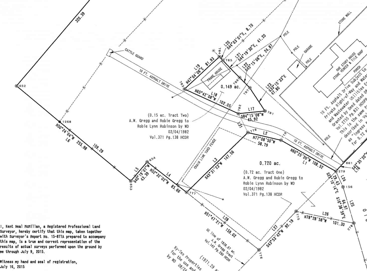

Here's a portion of the map that accompanied that description that shows how the point nos. used in the description and on the coordinate list are also annotated on the map.
The line annotations, "L(no.)" refer to a line data table that also lists the record data for the same line from various sources.
