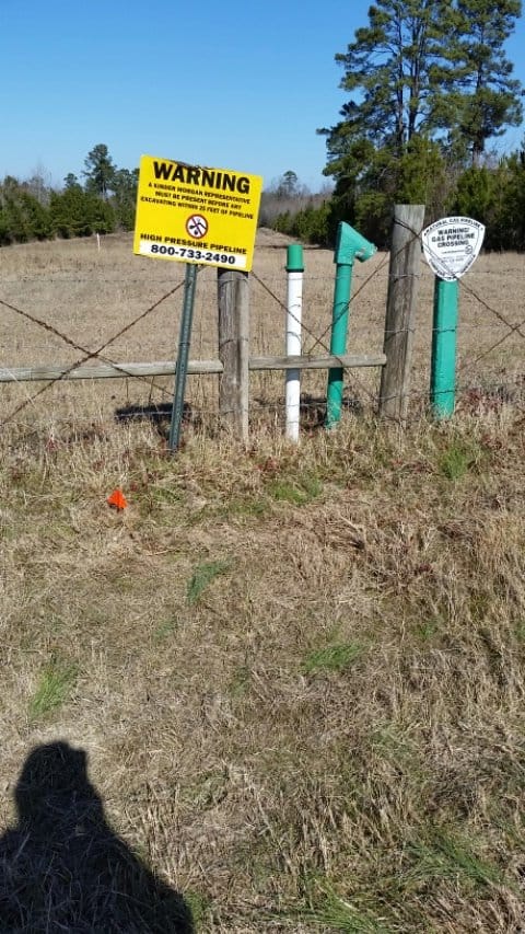

Opps, I set a 30in 1/2in rebar on r/w of TxDot road at the wire flag.
All these 5 pipelines are supposed to be a minimum of 48in underground.
I did stab a fiberglass probe before driving rebar in ground.
Usually I set a 6 1/2ft red tpost at least 2 1/2ft to 4ft deep by my monuments, not here
