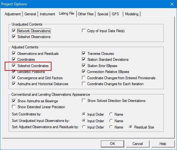

i thought Star*net first adjusts network nodes, then adjusts side shots. But I can't get the sideshot points to show up in the listings, and it's not outputting adjusted data either. Something simple I'm missing?

But if your sideshots aren't showing up on the coordinate page, something else must be going on.
Posted : August 12, 2016 9:50 am
There must be something else wrong then. I have that checked. Here's the one data file that has point "7" in it.

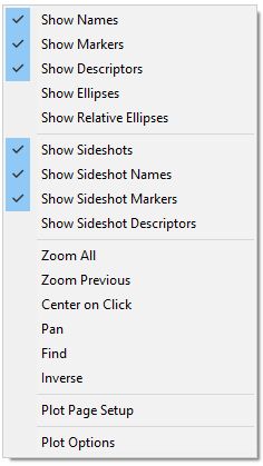

rfc, post: 386003, member: 8882 wrote: I see it in the "Coordinates" tab (three times, no less...haven't gotten to that yet), but not in any of the listings and not in the plot.
When you right-click in the plot screen, do you see "Show Sideshots" checked?
(You see 3 records for point 7 in the coordinate listing because you have the measurement record type as SS. You need to change that to M in order to have Star*Net treat all the foresights as the same point.)

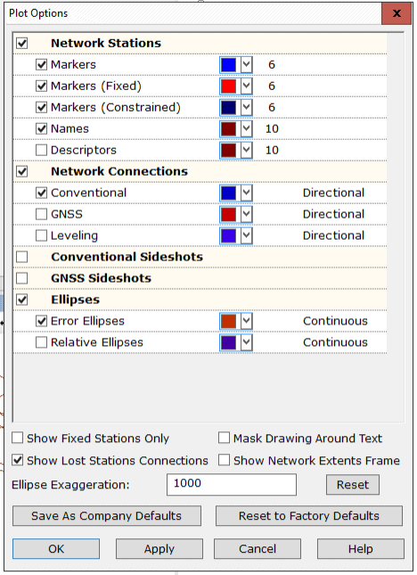

I'm running the demo of v8.2. Right clicking has fewer of those options:
And in "Plot Options":
Why would they eliminate side shots as an option?
I'll change the SS lines to M lines and see what happens though.
Posted : August 12, 2016 10:59 am
Thank you, Sir. Both of those suggestions work.
