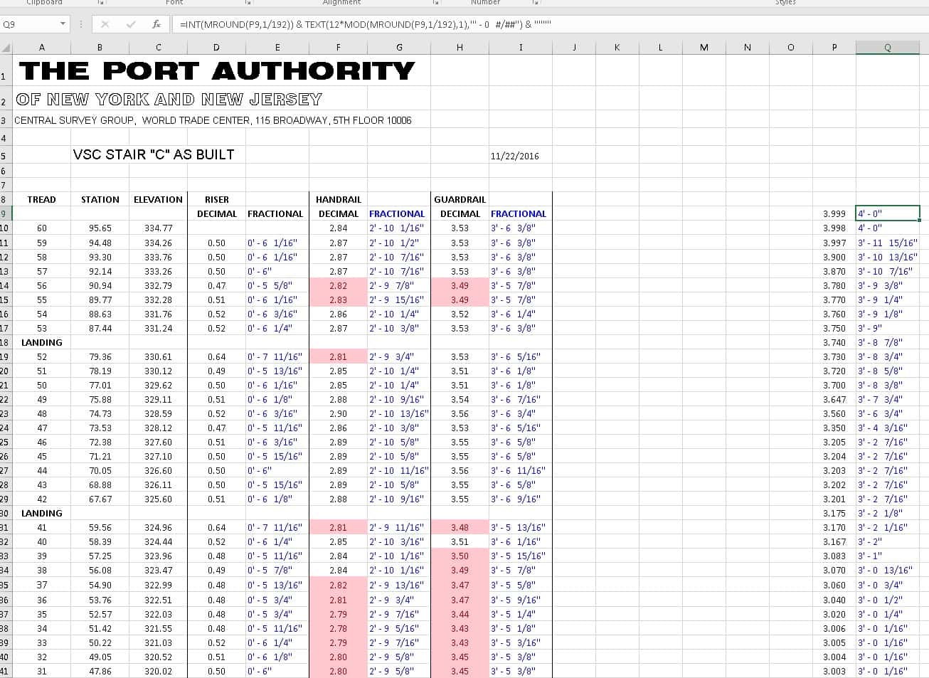

Finally got the formula perfect (except for negative numbers, oh well).
Anybody see any additional improvements that could be made?
Formula used in attached pic, with formatting spaces and 0 place holder;
=INT(MROUND(F10,1/192)) & TEXT(12*MOD(MROUND(F10,1/192),1),"' - 0 #/##") & """"

Why is 0.50 sometimes 6-1/16" and other times 6"? (Maybe I'm missing something. I was just glancing @ it)
Posted : November 28, 2016 9:52 am

I see that as well, in cells H33 and I33 3.50 comes out as 3' 5 15/16"
Posted : November 28, 2016 10:03 am

Tom Adams, post: 401296, member: 7285 wrote: Why is 0.50 sometimes 6-1/16" and other times 6"? (Maybe I'm missing something. I was just glancing @ it)
Guessing from looking at the last two columns, the decimal data in the main table likely has more digits than are being displayed.

Ah yes, decimal cells have three decimal places input but formatted down to two for display.

Could you fix the negative numbers by using absolute value? ABS(number)
