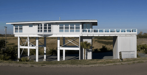

Zero elevations around here could be a problem. A lot of the ground is reclaimed swampland and is below sea level, behind levees. The zero contour line exists!

This is how finish floors are built above base flood elevation.
