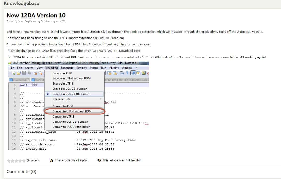

I encountered and had trouble with the endians on one occasion - importing 12DA file format to Civil3D:

You're talking about endians in Unicode encodings. That involves writing an integer representing a character, such as '??', with the bytes in some order. In the geoid file, the number representing an elevation, or the latitude, longitude, or number of columns or rows in the header, is written with the bytes in some order.
