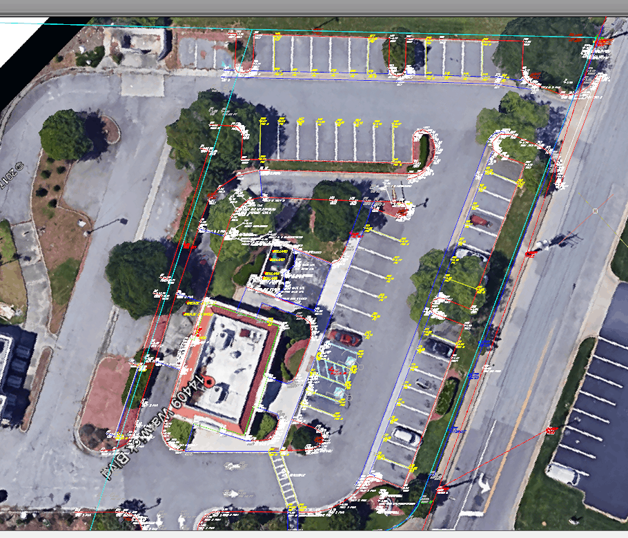

This is a aerial picture from Google Earth overlaid on the field work location of my crew. I used two back of curb corners to translate and rotate between the two and I must say the newer "3D Buildings" aerial is quite accurate. It's actual kind of scary how accurate. I wonder how long it will be before we are out of the picture and some guy at the computer is drafting all improvements from google earth.

pretty sure about every fourth as-built i'm reviewing these days is drafted straight off GE.

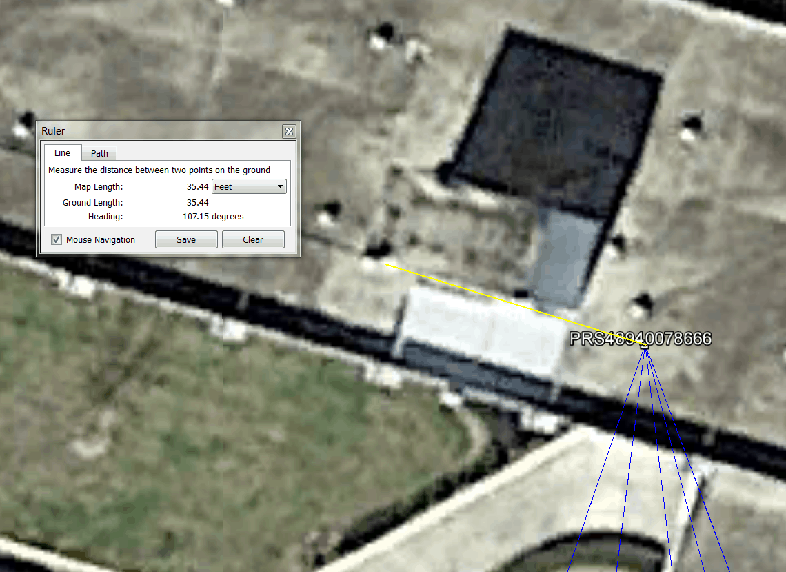

Sure it's spatially accurate... the key words there were "translated & rotated". This is how far off (from real world coordinates) Google Earth CAN be - your mileage may vary...
This is the antenna of the CORS station at Nicholls State University and where the coordinate fell in GE.

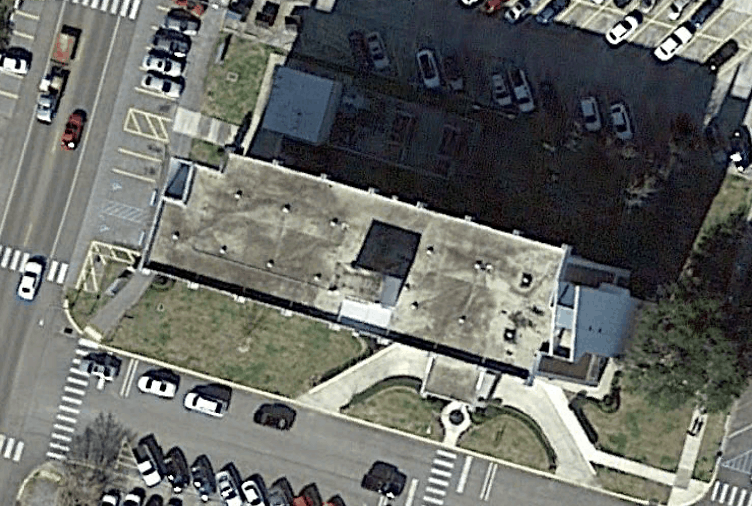

This is the same building zoomed out for perspective - the GPS antenna is on a mast that is bolted to the south face of the elevator shaft on the west side.

To me the difference with the cors station is the perspective of the picture at the elevation of the top of the shaft. I've found GE accuracy to be quite close geographically, when comparing against cell tower locations I've surveyed.
This survey is on assumed coordinates an I was just amazed at the accuracy of the ground level features.

Good point - the top of the elevator shaft is probably 100' above the ground, it's about an eight story building; the mast is probably another six to eight feet.
