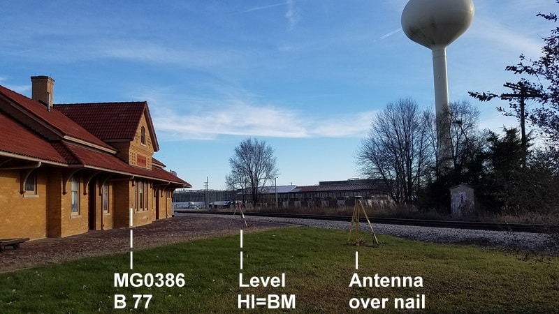

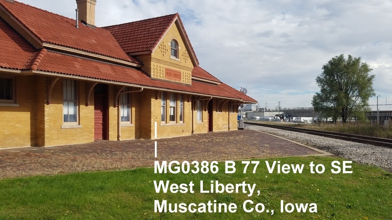

I tried my GPS setup method today for the vertically-mounted bench mark. This should be a more stable one than a post or culvert. Sky visibility should be workable, although not great. The roof is clay tile, not metal. We'll see later how the elevation comparison comes out, even though I don't think NGS will use it for GPS on BM.
Foresight distance = backsight distance = 26.5 ft.
Topcon auto level fine tweaked to HI = benchmark line.
GPS antenna set to same height, ARP Height=0.000 relative to BM.
Later, rechecked for settling with the level in two other positions.
Setup took way too long, but it was a very nice day for November. I picked what I thought was the best available (least bad) antenna position and taped and re-taped to put the level at equal sight distances. Found the antenna tripod couldn't go high enough. Moved to a closer position, not a whole lot worse visibility, and re-taped sight lines. Still not high enough, so had to swap tripods with the taller one under the antenna and the shorter one on the slightly higher brick-paved area for the level. Adjust legs, level the instrument. Check against bench mark. Readjust legs, repeat a lot of times. Final height adjustment with the tribrach screws. Repeat for antenna tripod height.
But despite all the fussy work, I'd bet my ARP height is as accurate as, and less likely to be blundered than, a measure-up.

This measurement was done to check one on a culvert 3 miles away.?ÿ The culvert disk measured 44 mm low using Geoid12B versus the NAVD88 value on the data sheet.?ÿ The vertically mounted one measured 51 mm low.?ÿ?ÿ Comparing eight disks I have measured (not all shared), as listed in another thread, these were the furthest off the data sheet NAVD88 values.?ÿ Both are about 38 km away from the nearest station in the Geoid12B list, somewhat of a gap. Some of my measurements were very close using Geoid12B, indicating I didn't have a systematic problem with ARP heights.
https://surveyorconnect.com/community/gnss-geodesy/bench-mark-stability/paged/2/
Using xGeoid17B, they are of course far off the NAVD88 values, but all eight are consistently different from NAVD88 by amounts with a spread of only 17 mm.?ÿ My conclusion now is that the culvert measurement was pretty good, and Geoid12B is off a few cm in the gap between stations used to define it, but the GRAV-D data has fixed it in xGeoid17B.
So I got my check value, and it isn't super important to submit the session on the vertical disk.?ÿ I would still like to if it wouldn't cause any trouble, but it sounds like it might not fly.
