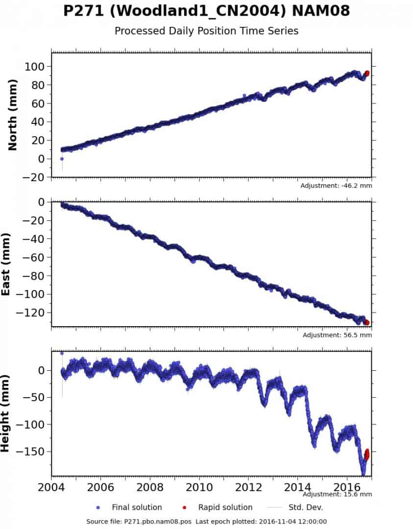

spmpls
(@spmpls)
Posts: 660
Here is a time series plot from a continuous GPS station that is on the Pacific Plate. You can see how fast and far it has moved in a northwesterly (negative east) direction relative to the reference frame. Even projects that only take a few years from start to finish in an area like this will have significant changes in the position of the control in that time. That is why we have to lock the project coordinates down to the date they were established, basically an epoch date, and manage the control over the life of the project to make sure it isn't breaking down, in a relative sense.

SPMPLS, post: 398512, member: 11785 wrote: Even projects that only take a few years from start to finish in an area like this will have significant changes in the position of the control in that time.
SPMPLS:
Don't want to take the thread too far off topic, but can you explain what the cyclical nature of the elevation means? It looks like there are actually two harmonics, one annual and another about every 10 years or so.
Posted : November 6, 2016 6:52 am

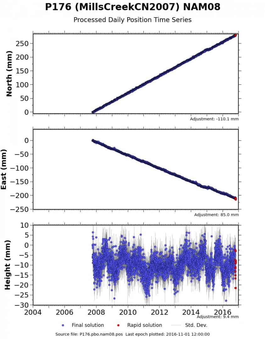

spmpls
(@spmpls)
Posts: 660
The "pattern" in the vertical component is primarily a seasonal influence. However, if you look at the scale, the low to high range is only about 30 mm, which is much less than for stations located in the valley areas (agriculture production) of California. Below is a time series plot for a station just northwest of Sacramento. Although hard to tell because of the scale, the seasonal range is about 4-5 cm from low to high, with a slight downward trend between 2004 and 2012. We entered into the now 5-6 year drought in about 2011, so the influence of the additional ground water pumping induced by the drought is seen in the sharp downward decline (subsidence) and more drastic seasonal highs and lows. There are some stations in the San Joaquin Valley where this is even more pronounced. So, not only do we have to account for the ever-present horizontal velocities, we also have to be aware of the possibility of downward movement in our control. Even in non-drought conditions, networks that are re-surveyed periodically (typical to monitor subsidence) are done at the same time of year each time, to help remove the seasonal noise in the vertical. If you look at the north plot, you will see a correlation between where is starts getting "bumpy" and the vertical plot below. When the vertical changes are extreme, they influence the horizontal position as well.
Posted : November 7, 2016 8:47 am
P271 is nearby and I use it a lot, but I *never* constrain it. During the 2014 drop shown in the plot above, the cluster of wells on a nearby ranch that were pumping water for a large-scale water sale (groundwater was being substituted for river water that was sold to a downstream buyer) was less than 3 miles from P271. The rebound was only partial, indicating permanent partial collapse of the aquifer. The 2014 drop was dramatic enough that pumping for a 2015 sale was distributed across a more widespread network of wells.
I'm not sure what's behind the 2016 drop. The nearby ranch didn't sell any water in 2016, so something else must be going on.
Posted : November 7, 2016 9:26 am
