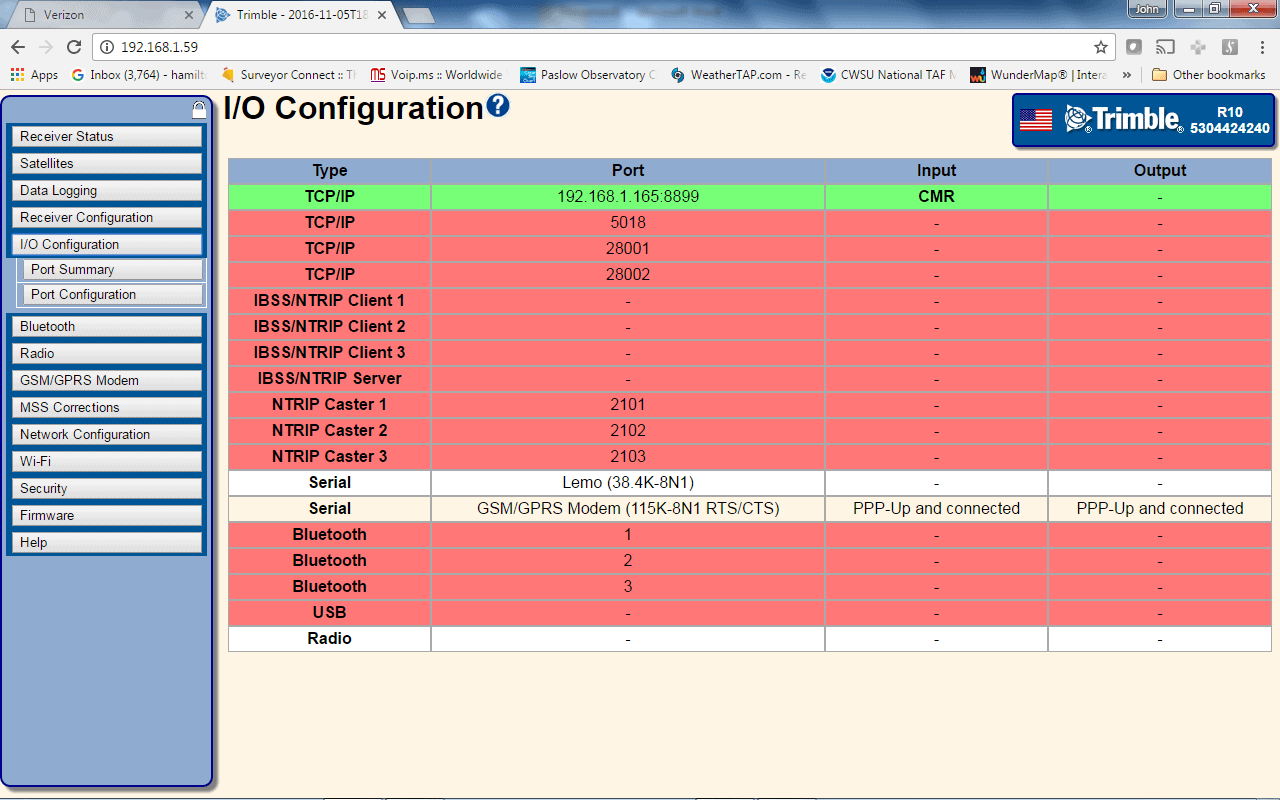

I have been trying off and on to setup a recently acquired Trimble R7 as a portable base station with CMR corrections transmitted over the cell network. I do not have a cell modem yet, so I am working on getting it working internally. I do this all the time out in the field with my R10 (with a GSM modem internal), but I want to use the R7 instead. Today‰Û?SUCCESS (sort of).
I have the R7 setup to transmit CMR+ out port 2 (custom radio). I acquired a serial to wifi converter (took a while to get it-bought it on Amazon but it shipped from China: http://www.usriot.com/p/rs232-rs485-wifi-device-servers/ ), set it up on my internal network, with a port of 8899. I connect the R7, start the survey, and the rx light on the serial to wifi blinks.
Next, I set up my R10 and connect it to the internal wifi as well (different access point on other side of building). I configured one of the TCP/IP ports to connect to the internal IP address and port 8899. That worked.
Looking at the position screen, it shows an RTK position, and if I use the data collector I can do an RTK survey (set to internal radio, even though it is not actually using the radio, which is the same thing I do when I connect the R10 directly to an NTRIP server, not going through the DC). So I am sure the setup works.
To summarize, it works fine on my internal network, which is transparent to the rover, it thinks it is getting corrections from a radio. No NTRIP involved.
So I then open up that port (8899) on my router. I have other devices (camera server, ftp, etc) that I did the same thing on and they all work from the outside world.
When I then disconnect the R10 from the internal network and connect using the GSM modem, that particular port (using the current IP address of my network, which is dynamic but hardly ever changes) does not connect. If, instead of typing in the IP address, I type in a domain name, it resolves to the correct IP address (which means 1) it is connected to the internet and 2) the IP address is correct). I do have a dynamic name service setup, so my domain name will resolve to the correct and current IP address. I know it works because I connect to my security cameras that way and we send data to an internal ftp server from the field.
I think it has to do with a port forwarding issue, but I can't figure out why, since I opened up the ports on the router same way as with the other devices internal that need access from outside.
My next step is to get a cell modem and use that instead of the serial to wifi device. But, i want to be sure that what i am trying to do will work. Based on it working internally, I don't see why it wouldn't, but being unable to access it from outside leaves a doubt in my mind.
I would appreciate any advice from anyone as to what the problem might be. The cell modem isn't terribly expensive ($300), so I may just go ahead and get it and try to get that working.

Additional info...I setup the R10 as an ntrip server on the internal network (works in this configuration externally using GSM modem), using port 2101. I then opened up 2101 on the router. I tried to connect using the Lefebure NTRIP client on my phone. I use this app to test the connectivity when setting the R10 up as a base.
It keeps saying
"Network: Connecting..."
and then
"Network Connection dropped"
More evidence that it is my router blocking it? Or could it be Verizon (I have verizon fios)?

John, I am a little confused by your situation, BUT did want to throw out there that to connect to my RTK bridge I had to have a static IP, no problem with the bridge hooking to a RTN, but no go on hooking to the bridge over a wireless carrier without a static IP (to use as a NTRIP server or to change a configuration remotely), even though the assigned dynamic IP usually remains the same until a power cycle. ALL incoming non fixed IP addresses are blocked at the carrier level.
Not sure if this relevant or not at this stage, BUT likely will be once you move out of the office test environment and try this over a cell network.
