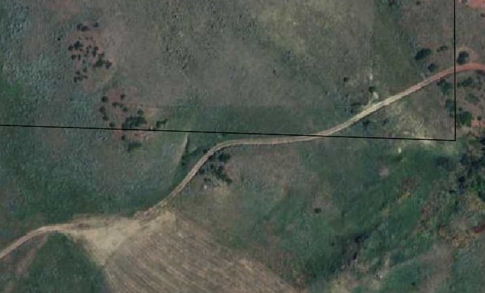

Just had another case where there was a fence line, it was "off" the deed line, looks like it was stopped short of an old access road, so the people with the access took the neighbor to court to establish the line as the property line.
The defendant owns the land the road crosses by section breakdown, the plaintiff has connecting lands but can't access them along the road without crossing the 1/4 line of the defendant.
The defendant won, the court rejected the idea that ownership was established by the road and the fence, this isn't a supreme case, but it's the second one in a few years that rejected a fence line (and in this case a road) as marking ownership to the lands.

That's not surprising. Convenience fences typically aren't held to be boundaries.

Yes, telling the difference between a boundary and convenience is the trick. And in this case the dispute.

It makes sense that the fence would be on the owner's side of the road even if the boundary is on the other side of the road. Presumably the idea is to keep the livestock out of the road. We have numerous cases that find the fence was in a convenient alignment and was built to turn stock, not to be a boundary fence. This is a good example of answering a question of fact, was the fence built to be a boundary or for some other reason?

It's clearly a division fence, but on the other hand it probably isn't on a section breakdown, at least the GIS shows it isn't.
Anyway the court decided the plaintiff doesn't get the lands on their side of the fence, in the previous case the division fence went along a ridge east of the section line (at least for forty years), the person to the east wanted to put it on line, the guy to the west sued to stop him and he lost. Both cases are in the same general area.
Both of these cases are kinda slowing down the idea of adverse possession and acquiescence in this part of the world, it's gone from ranchers thinking they own without reservation to anything on their side of a fence, to them at least considering the idea that maybe those fences aren't really boundaries.
