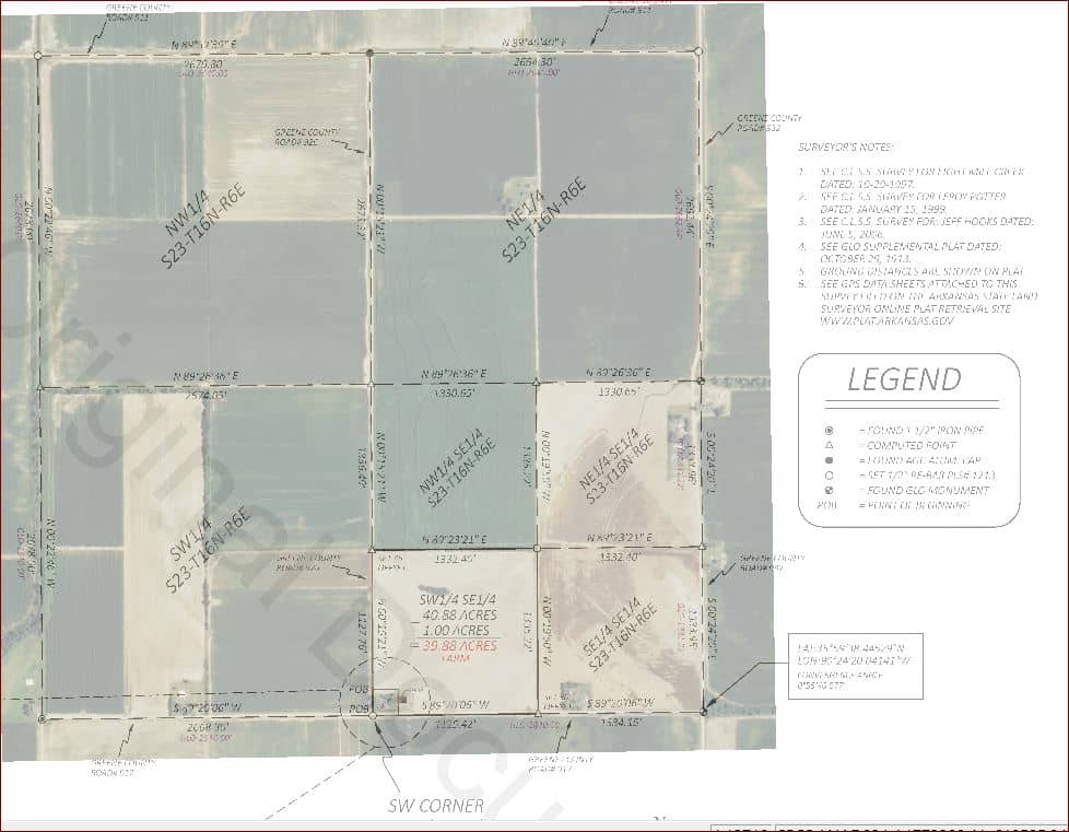

Attached link is a survey we did a while back. Is the PLSS data sheets worth the extra time or is the plat sufficient??
http://geostor-plats.geostor.org/Greene/JB4135.pdf

As a business decision, hard to say, but I suppose you're set up to generate those data sheets pretty quickly.
But professionally--Wow! I think it's great, and not just bells and whistles great, but a real help to following surveyors and the actual client.

In Oklahoma we are required to prepare a document something like that and record it every time we find a PLSS corner that isn't exactly in accordance with the last recorded CCR. As a matter of fact yours looks a great deal nicer. As Frozen North says your clients may or may not appreciate them. But over time you will collect enough of these to make your files worth money to someone when you go to retire.

I like those, are the sheets filed separately as corner records, or are they filed with the plat?
If I show coordinates I will include the Epoch, and you may want to say somewhere that they are in feet (I'm guessing its not meters).

MightyMoe, post: 439863, member: 700 wrote: I like those, are the sheets filed separately as corner records, or are they filed with the plat?
This survey plat is the filed copy at the state website, so this is all filed together.
This is not an official corner certificate.
Here is a link to what they look like.
http://surveyor.arkansas.gov/wp-content/uploads/2016/10/Land_Corner_Restoration_Certificate.pdf
It is not a common practice in our county to file corner certificates. We are actually in the process of getting a contract with the state to set state monuments and file corner certificates.

I really like these data sheets, in Colorado we are required to submit monument records to the state but not with this detail. Some surveyors don't even bother showing the bearing or set tags on fence posts that are not stable. I like the location, that would take the guess work out of replacing a destroyed monument in the future.
One suggestion bearings to the second and distances to the hundredth on poles and pedestals is a little over kill.

An aside aimed at the descriptions. It would be helpful to include what certain calls are running with when there is a definite thing. For example: Thence north 0 degrees 20 minutes 14 seconds west along the quarter section line, 188.47 feet. Or, even better, along the west line of the southeast quarter of said section....................... I believe that is what you are intending to achieve in certain calls. Adding the specific qualifier clears up the future issue of an expert measurer running a new line at the record bearing, as they determine it, rather than along the intended aliquot boundary line.

SIT,
I suggest a more detailed explanation of the evidence you found (GLO corner) and the methods used to "set" the Sections corners.
I appears that the NE corner was set on an 'extension' an the NW corner??? how?
Suggest the GPS form explain classification...A, B, or C...original evidence , perpetuation of original evidencr, or BLM proportion.

Excellent point, DDSM. Apparently, no attempt was made to find the true center corner, if there was one in place. Nor the west quarter corner. I have no idea why the northeast corner was set on this survey as it has no influence on the area surveyed. How it got set cannot be determined by the information provided.
A pet peeve of mine, based on many years of experience is subdividing a section without finding or setting those corners that would control. In this case, west quarter corner, center corner, and the nw and se corners of the subject quarter-quarter for which a description is written.

Holy Cow, post: 440232, member: 50 wrote: Excellent point, DDSM. Apparently, no attempt was made to find the true center corner, if there was one in place. Nor the west quarter corner. I have no idea why the northeast corner was set on this survey as it has no influence on the area surveyed. How it got set cannot be determined by the information provided.
A pet peeve of mine is re-subdividing a section 50 years after the lines have been established. (What are the mathematic dimension of a square acre...another pet peeve)...
Zoom a Google earth of the supplied lat/long.
SIT gives a link to Arkansas' plat/corner records...a search will find use/recovery of established 1/16th corner monuments in the section.
