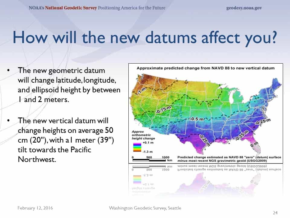

gschrock, post: 357802, member: 556 wrote: We get about 4.3' Hz and 1/3' V up here. Dru Smith had a slide (generalized) of the expected shifts from NAD83 - IGS/ITRF/WGS-ish in Friday's seminar (will get the whole thing posted soon).
Gavin,
Yeah...I've followed the "NEW-NAD" pretty close for the last few years, personally...I can't [hardly] wait!
Interestingly, I participated in a Control Survey in Northwestern Utah last Fall, and the "predicted NEW-NAVD" numbers are quite close to the NGVD29 values. That's going to confuse some folks in a few years...

Loyal, post: 357806, member: 228 wrote: Gavin,
B-)
The 29 numbers got raised by 2.3-2.5 feet here. the predicted new numbers go lower by a bit over 2 feet.
We are putting together a survey for a chain store in a subdivision we did about 10 years ago with lots of flat "wet" lands near a creek.
10 years ago the FEMA maps were still based on NGVD29 with really good control so that's what the subdivision got.
Then a couple of years ago they finally got the new flood maps released so they are NAVD88 and this ALTA is "bumped" up 2.34'
Probably if a store goes in next door to this one in a few years, maybe just go back to the older drawings, so much fun.
But my guess is because of how difficult these FEMA maps were to get done, NAVD88 is going to be around for a long time.

MightyMoe, post: 357832, member: 700 wrote: NAVD88 is going to be around for a long time.
I hear ya Mighty!
I still work on projects that are expressed in NAD27 and/or NGVD29, and don't expect most of those to jump on the next datum either. The really fun ones are those (oh so many) burgs where the entire infrastructure is based on the Elevation STAMPED on the Brass Cap in the Court House Steps, which is rarely (if ever) the same as the adjusted Official Value (of which there may be MANY).
BUT...it works, ain't broke, and should NOT be fixed by some expert measurer with a shiny new Black Box.
Posted : February 14, 2016 5:22 pm
