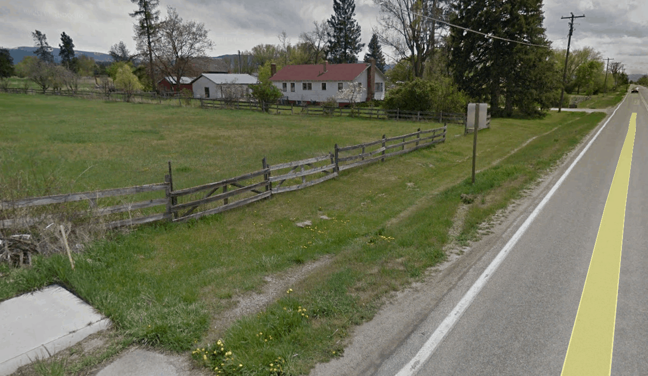

Rankin_File, post: 440736, member: 101 wrote: your opinion of the quality of the survey doesn't change the fact that the owners paid for it and are relying on it to further their improvements, and undoubtably will use it in the future to convey their interests.....
I'm not sure this is the actual subject property, but it does seem to be representative of the area. I'm pretty sure you can hide 0.2' of right of way occupation here someplace. Or is it 0.1'?

Mark Mayer, post: 440808, member: 424 wrote: I'm not sure this is the actual subject property, but it does seem to be representative of the area. I'm pretty sure you can hide 0.2' of right of way occupation here someplace. Or is it 0.1'?
I don't have to hide what I'm doing- I'm not a frightened fudger.... (thank you Christian Clausen for that AWESOME term)
