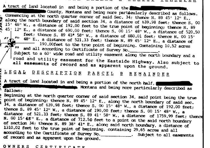

Tom Adams, post: 440183, member: 7285 wrote: Rankin File's description is for a "right-of-way easement" which would not effect the property owner's boundaries. (maybe the right word would be "affect" - I think "effect" as I hijack my own sentence) I was confused as to if/what the description had to do with the case cite. It's not about the discussed "South Street" is it? At any rate, the owner of the underlying fee would be the same, and encumbered by an easement. If the adjoiner's were in a situation that involved "proration" it would have no bearing on the right-of-way width. I am a little confused what the description has to do with the discussion. (although) I don't think I've seen a strip description of a highway right-of-way easement before.
They are pretty standard here for that era- the problem now is that, the successors in interest to the parcels almost invariably were conveyed a parcel that ended at the R/W line.
Posted : August 7, 2017 10:49 am
Posts: 4079
Mark Mayer, post: 440152, member: 424 wrote: No mention of any monuments. The centerline is called for, and monuments are found which seem to fit the map from which the description was prepared. This confirms my thinking that the monuments you found are references to the centerline, and that the right of way is the exact width called for in the deed. That's how I roll.
ok- so you are going to put your pin touching the pipe, or just pincushion on paper?
Posted : August 7, 2017 10:52 am
Rankin_File, post: 440486, member: 101 wrote: so you are going to put your pin touching the pipe, or just pincushion on paper?
Probably on paper. Is this particular monument at a property corner or just a line stake?
Posted : August 7, 2017 10:58 am
Posts: 4079
Mark Mayer, post: 440487, member: 424 wrote: Probably on paper. Is this particular monument at a property corner or just a line stake?
corner
Posted : August 7, 2017 11:01 am
Rankin_File, post: 440485, member: 101 wrote: They are pretty standard here for that era- the problem now is that, the successors in interest to the parcels almost invariably were conveyed a parcel that ended at the R/W line.
Do you know how courts have handled that situation? If you call to the "right-of-way" line, that call would be presumed to be the center of the right-of-way. But from you you're saying, the call to the ROW Line is probably a distance call that would be to the edge of the ROW or the ROW LIMITS. I would hope that the call to the ROW Line would hold the distance to the center of the ROW and the distance call would give to the actual center.....(but I could see how that might not hold)
Posted : August 7, 2017 11:09 am
Rankin_File, post: 440488, member: 101 wrote: corner
Then the monument may control the side line of the private property. Even though it's likely not called for in their deeds either. But because those adjacent private owners can acquiesce to it as controlling their common line. Monuments don't acquire their dignity as controlling boundaries from the surveyor, and they don't acquire it by "being there a long time". They acquire it when they are called for in a written and properly acknowledged document, or when there is an unwritten agreement, in some form, between interested parties who are legally able to make such an unwritten agreement.
But given that a right of way is a form of easement, that the fee title remains in the adjacent private owner; that the state intended to acquire the specified width and only the specified width, no more and no less; and that if the monument was inside the specified width the state would, surely, expect to retain and exercise it's rights to the full width; that the state cannot be adversely possessed against, nor can an unwritten agreement be concluded because there must be at least 2 interested parties for there to be an agreement; and, finally, that no monuments are called in the deed of dedication, I'll be assigning the stated widths to rights of way.
I'll further state that as a surveyor who has worked mostly in recording jurisdictions, having seen many, many surveys of rights of way by others, and having prepared right of way recovery surveys for 2 state DOT's, I cannot recall a single instance where anything other than holding the full width and only the full width was ever done, by me or by anybody else. It's the common practice.
Posted : August 7, 2017 11:42 am
Posts: 4079
Tom Adams, post: 440489, member: 7285 wrote: Do you know how courts have handled that situation? If you call to the "right-of-way" line, that call would be presumed to be the center of the right-of-way. But from you you're saying, the call to the ROW Line is probably a distance call that would be to the edge of the ROW or the ROW LIMITS. I would hope that the call to the ROW Line would hold the distance to the center of the ROW and the distance call would give to the actual center.....(but I could see how that might not hold)
ummmm, no.

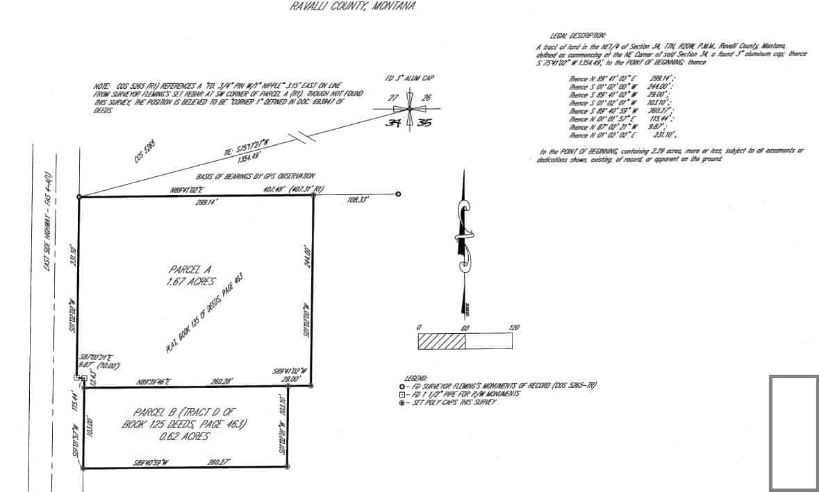

Here's the latest survey- the referenced deed it too old to be available online, so I'll have to pick it up at the courthouse.....
(the ROW break we're talking about is the break from 30'- 40ft in the SW corner of Parcel A
Posted : August 7, 2017 11:57 am

Rankin_File, post: 440499, member: 101 wrote: Here's the latest survey ...
I don't find that to be a very impressive survey. Unless there is more to it which you have not shown us I can assure you that it would not pass muster in Oregon. The surveyor has not shown us how he developed the right of way line south of the 30/40 corner at all. The legal description makes no call to the right of way nor to any controlling monument other than the remote section corner. And "BASIS OF BEARING BY GPS OBSERVATION" is pretty much a red flag.
Posted : August 7, 2017 2:22 pm
aliquot
(@aliquot)
Posts: 2323
Mark Mayer, post: 440541, member: 424 wrote: I don't find that to be a very impressive survey. Unless there is more to it which you have not shown us I can assure you that it would not pass muster in Oregon. The surveyor has not shown us how he developed the right of way line south of the 30/40 corner at all. The legal description makes no call to the right of way nor to any controlling monument other than the remote section corner. And "BASIS OF BEARING BY GPS OBSERVATION" is pretty much a red flag.
This is one of those "this is the boundary because I say so" surveys, unless there was note explain the SW cor. of Tract B. There are times when not tying to something south on the ROW would be appropriate, but it certainly requires an explanation.
I do think the "10.00" ROW jog was treated correctly, but that basis of bearing statement makes it hard to give him the benifit of the doubt.

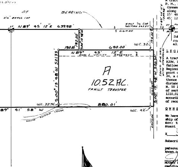

your opinion of the quality of the survey doesn't change the fact that the owners paid for it and are relying on it to further their improvements, and undoubtably will use it in the future to convey their interests.....
Here's the survey for the other side of the road...
What are the odds that the centerline of the rd varies between the 2 surveys and where I would calculate it's position as now?
that's the beauty of imaginary boundary lines.....
