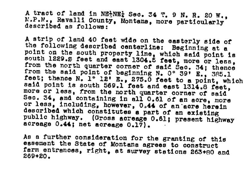

aliquot, post: 440100, member: 2486 wrote: What is the 60.2' between? The pipes that are supposed to be 10' apart?
the pipe at 30 ft lt and the pipe at 30 ft rt.
Posted : August 4, 2017 8:04 am
Rankin_File, post: 440097, member: 101 wrote: do you think they are monuments on the Right of way or merely references to the centerline?
I'd like to see the text of the acquisition deed before committing myself fully, but based on the map alone I would treat them as references to the centerline.

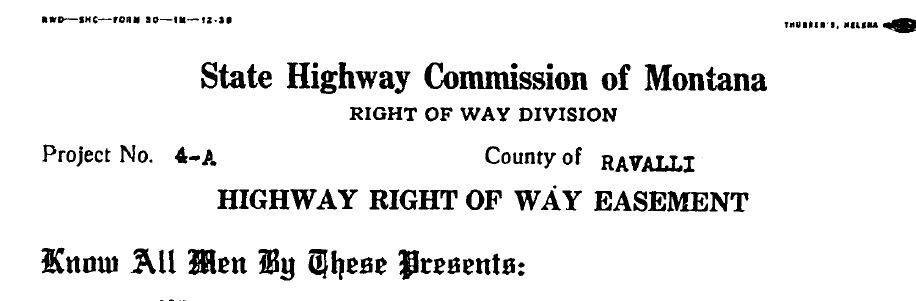

The above is a "right-of-way easement". The adjoining owners would own to wherever their common line and the easement would be over and through their land. If Proportioning were involved you not take the easement into account.

Wohl appears to be more of a title case than a location case to me. The Plats dedicated 60'; the city tried to cook up a theory that the dedication was 91' based on remote parallel streets being further north and south of South Street than indicated on the Plat. In the case of an excess the subdivider did not know common sense dictates it went to the adjoining lots, not the R/W dedication which any subdivider would keep to the legal minimum. If a description states a number it can't be changed by extrinsic evidence.
This is factually distinguishable from the case where Bonner's pipe (original surveyor) is found 30.2' from the centerline. The pipe establishes the 30' line imperfectly but this is not changing a stated number in a Deed, just further refining it. The Court is correct, the City gets 60' under the facts and law of the case.

Rankin File's description is for a "right-of-way easement" which would not effect the property owner's boundaries. (maybe the right word would be "affect" - I think "effect" as I hijack my own sentence) I was confused as to if/what the description had to do with the case cite. It's not about the discussed "South Street" is it? At any rate, the owner of the underlying fee would be the same, and encumbered by an easement. If the adjoiner's were in a situation that involved "proration" it would have no bearing on the right-of-way width. I am a little confused what the description has to do with the discussion. (although) I don't think I've seen a strip description of a highway right-of-way easement before.
Posted : August 4, 2017 3:15 pm

aliquot, post: 440176, member: 2486 wrote: What purpose is there to reject it, what is the benefit of moving a boundary by 0.2 feet?
Why give away right of way just to hold a monument? Sometimes monuments are controlling. Sometimes they aren't. These ones are controlling - of the centerline.
Posted : August 4, 2017 3:46 pm
