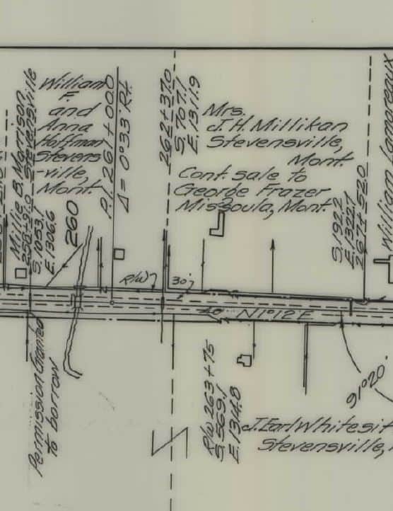

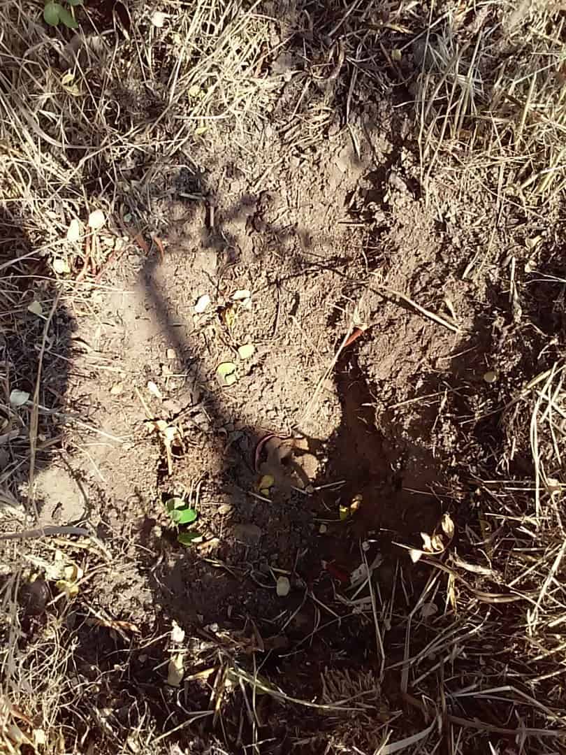

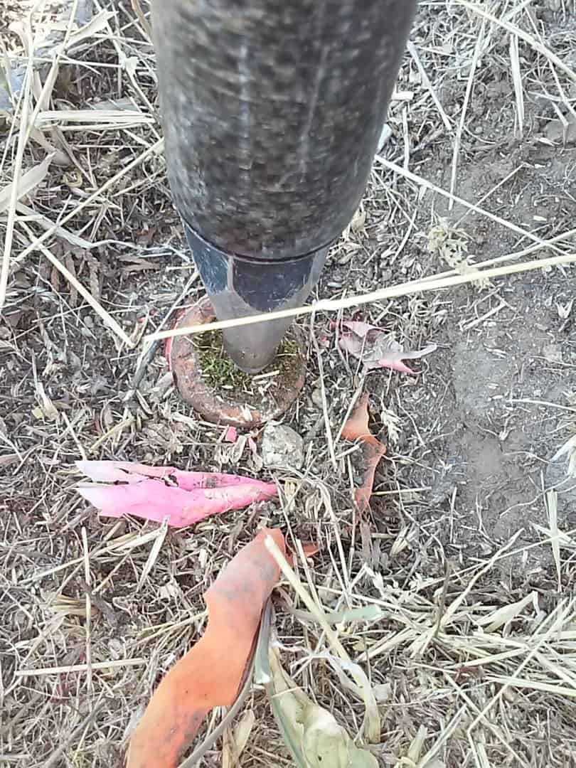

Posts: 4078
Here yesterday's finds- 2 pipes from 1939.
They purportedly monument a P.O.T. at 263+75 for a RW break at from 40' to 30' on the RT.
here is the pipe 30 ft lt of CL
This one is 30 ft rt of CL.
the position for the pipe at 40 ft rt of Cl is now occupied by a concrete set chainlink fence corner post.
they measure 60.20 ft between the pipes.
do you think they are monuments on the Right of way or merely references to the centerline?
Is the location of the 40 ft break 10' from the pipe at 30' or 40.00 ft from the centerline where ever that happens to land?
Posted : August 4, 2017 7:52 am
aliquot
(@aliquot)
Posts: 2323
Rankin_File, post: 440097, member: 101 wrote: Here yesterday's finds- 2 pipes from 1939.
What is the 60.2' between? The pipes that are supposed to be 10' apart?
Posted : August 4, 2017 8:01 am
