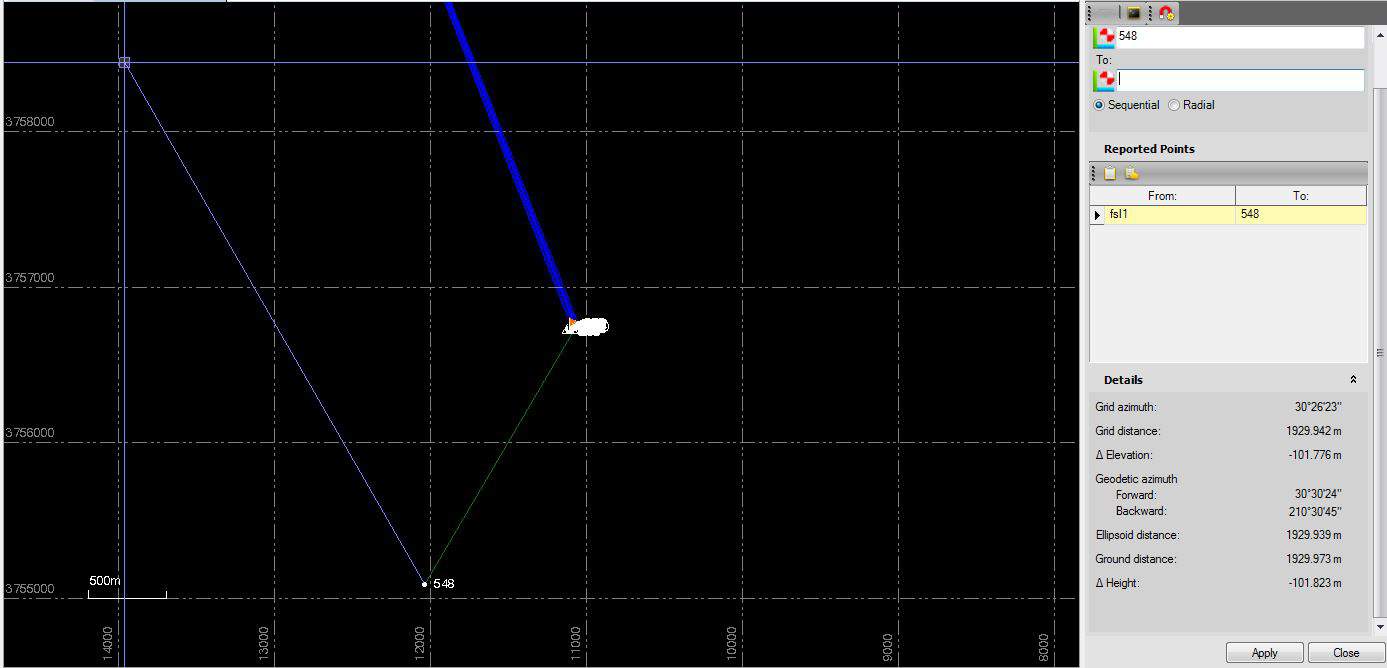

About 3 times a year I get a really bum shot from my S3, and I am not talking about something short due to an obstruction in the way, I am talking hundreds and even thousands of meters out..
Here is a screen grab from TBC showing one such bum shot, it is a reflector less shot 1929m , which is a physical impossibility as the laser is only rated to 300m, and i know you could do a 5000m shot in laser mode to a prism, but to discount that remote possibility, I plotted the points on goggle earth, it was on the other side a a mountain, so no possible visible line of site.
The shot was supposed to be to a building corner about 50m away .
This instrument has been in twice for this issue, no issues found.
It only happens a few times a year out of the thousands of shots we take with it, so the error is so obvious , its something to look forward to and have a laugh...
I have asked for an explanation, no one has ever given one, so I came up with my own one...
The laser on the s3 is phase shift, my s6 is time of flight, there must me an interruption in the phase shift pattern that causes the computer to incorrectly calculate there distance , I think the phase shift anomaly happens when the surface is a certain colour or texture that due to its contrast just confuses the s3.
I have learned to live with and always preferred my S6, thats until I l learned that the S6 laser is not truly co axial and that explains why you get bum corner wall shots and need to face 1 & face 2 reflectorless control placed on oblique surfaces.
Some day I will explain that story...
The S6 laser should be co-axial and can be adjusted using the provided torx screwdriver and target. You don't really need the target. Your dealer should do it as part of a calibration or the instructions are in the manual.
