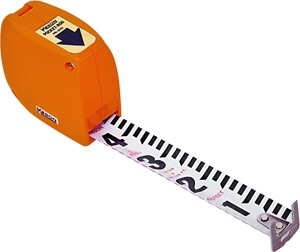

How do you do it? What do you use to measure the height of the instrument?

I measure to the bottom notch on the S6.
Posted : September 6, 2015 7:17 pm
For typical work I tape to the horizontal axis mark on the side of the gun, then cut 0.01'.

I use a Keson Pocket Rod to measure from the point to the marks to on the side of my total station. I've had the pocket rod for ever. Some where from the mid 90's. I use fixed height GPS rods. I measured the height of each rod to the antenna reference point when I first got em, so I use the same height for each rod and antenna each and every time. I do have a laser plummet on my total station. I have though for years a laser measuring meter to the setup point would be cool. I don't measure HI's when doing most rural boundaries, but if it's for an engineering firm, or if construction is a possibility, I do run elevations. Nothing worst than being asked for a topo after the boundary was run.

I use pocket tape.
That Horizon system is a game winner, gonna have to Redneck Engineer and Retrofit one of those gizmos fer sure.
