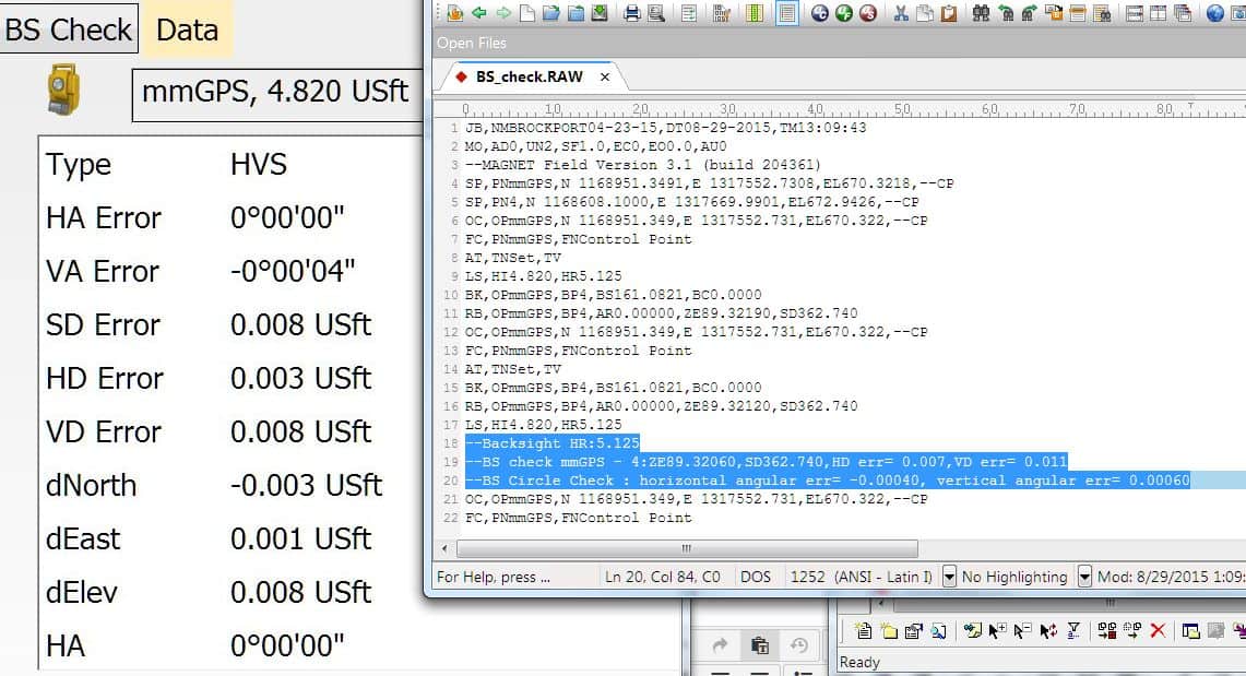

To check the BS and see what was displayed to field crew when they took a BS check. In Magnet Field, go to EDIT >Raw Data
Look for icon of a 360å¡ prism with green check through it. Then select the Data tab at top. I notice this old file created in 2.7.1 does NOT export the RAW data from Magnet 3.1 exactly the same as seen in Magnet. Much closer than you are seeing.
On the right is the text file RAW format for same job.
What instrument are you using. Wonder if a firmware is needed. I'm using GPT-9003
Posted : August 29, 2015 11:26 am

Yep, the guys are seeing the correct info when they take the shot, and then the other day I looked at the raw data on the collector using the same process you described above. Those items display correctly on the collector, just not in the raw once exported.
We are using a PS-103 with a 2600 collector running Magnet 3.1

The Raw data is still showing that the backsights are perfect. HD error = 0.000 VD error = 0.000.
This is after I slid the instrument 0.05' back and then shot it again.
I tried exporting a .raw file, a .rw5 file and others and all had the same result.
I have not tried this yet on a controller so hopefully it will work on there
Errors read correctly for me on the ToughPad with v3.2.
Posted : October 31, 2015 11:42 am
